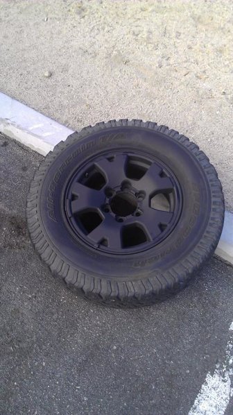

    do it. here is mine

    Here is mine done after cleaning, sanding, cleaning again, and 4 coats for sandable primer. No paint.

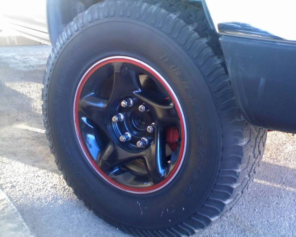

    I did you have the red pin-striped? How did you do it and was it a PITA?

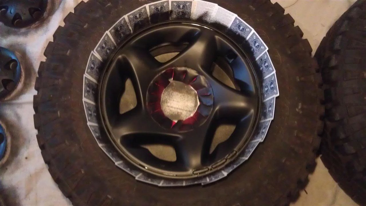

    The best way is to get cards and put them around the Rim and it keeps the spray paint out!
