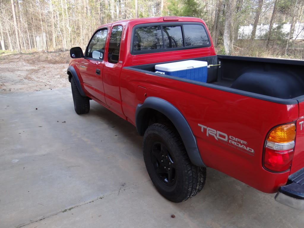

    I did mine, you have to excuse the unpainted weights, took it after i had new tires put on
