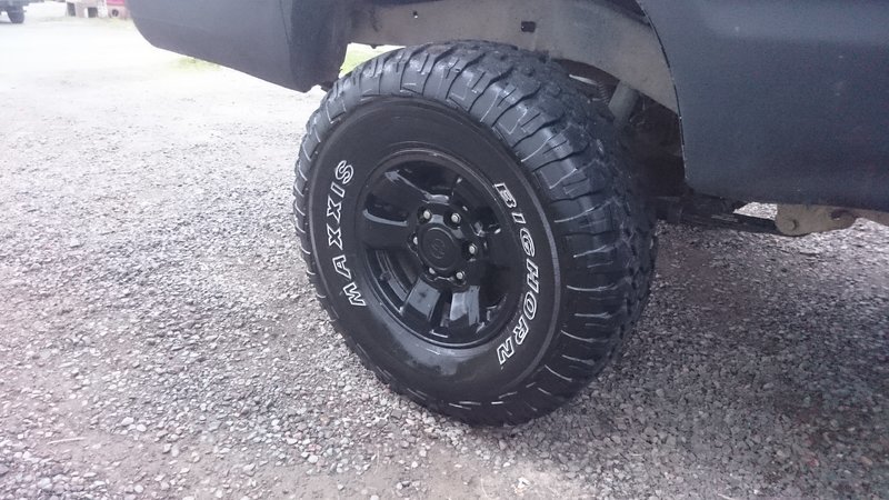

    Same kind of prep i would think. You need to rough up the surface a bit for the paint to really cling well. So if you start with like 120 grit then work up to about 1000 grit it'll be rough but still fairly smooth. Then 3-5 coats of paint and 3-5 coats of clear coat will filly the gaps and look smooth as silk as long as you don't over spray.
    as for the weights. No you don't HAVE to take them off..but you can. I didn't cause is just didn't want to screw with them at all. But you can just mark the location they were in with some tape or something and pop em off if you are comfortable doing that.
