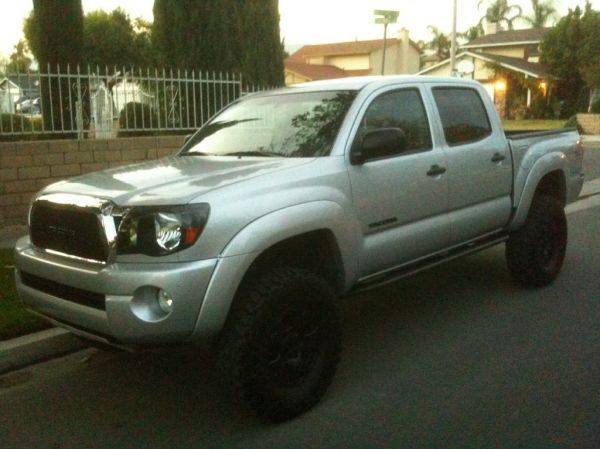

    Check mine. Look up "New Wheel Paint Design". Try and tell me that those look like crap!!!

  14. Nov 22, 2009 at 3:41 PM
