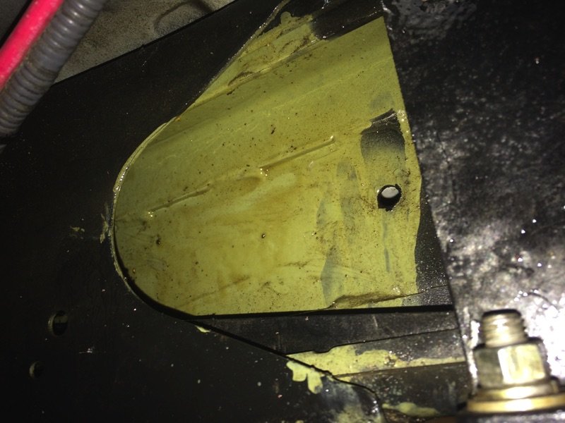

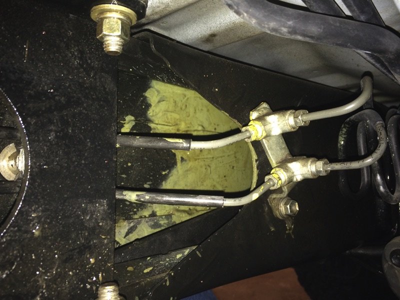

    do you have a pic of what this thick goo build up looks like?

    It's Fluid Film that is building up after I think about half a dozen applications. It really doesn't smell like anything. I'll see if I can get a picture of it sometime. It's not really building up that much. When it warms up in the summer it flows out a little and I wipe it down the frame.

    does it wash off or does it harden/have to scrape it off?

    Fluid Film doesn't harden, it's like a oily wax kind of consistency. It's thicker than kerosene but not quite hardened linseed varnish.

    so it will be rather difficult/messy to remove? like sludge in sewer pipes?

    It's not super hard to remove, it wipes off and you can use mineral spirits or acetone. But yeah down inside the frame or in nooks it's not really ever coming off completely. It does seem to leave a bit of residual film but I've been able to sand/prime/paint a few rust bubbles where I've covered before and it seemed to stick.
