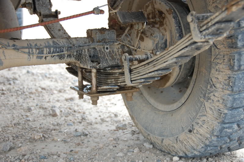

    Actually I fabbed some up using some flat stock 1.5" wide x 1/8" thick.
    cut 8 pieces like this about 3" long, drilled 2 holes high & low (just below the bottom of spring/just above top of spring) got some 3/8" all thread w/nuts & washers , cut all thread into about 3.5" lengths, ran it thru each hole, nut & washer on each end, tighten, done...

    pic of clamp , not great but you get the idea...

    Doesnt it move?

    well, if you loosen the nuts it does...

    Actually guys if you do this, I'd dbl nut it for good measure

    but i mean like as the leafs cycle wont it want to follow the leafs or does it stay in place?

    Thats a fair question, dont know yet I just came up with this a couple days ago, but I wouldn't think it'd move much, will have to R&D it a little..
