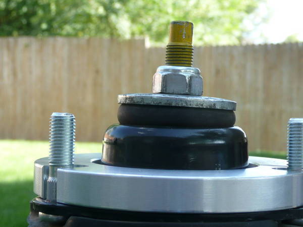

    Any tips on how you know you have the top nut down all the way on top of the top plate? I took it into 4 wheel parts to have them compress the springs. They compressed it and assembled with mostly everything lined up right, but they compressed on one side only, and the top plate is a bit catty-wompass (sp? :)), so I don't know if they seated the nut all the way down to the last thread of the shock top bolt or if you don't have to worry about that...
    See Pic
    I put the top plate ans spacer horizontal for reference, and you can see the top bolt angled. The rubber cushion is assymetric as the other clue.
    I could hear that lower washer rattle under the top plate (the silver cupped one that goes between the shock and the top plate), so I had them take it back and crank it more, and can't hear that rattle now...

    It looks good.
