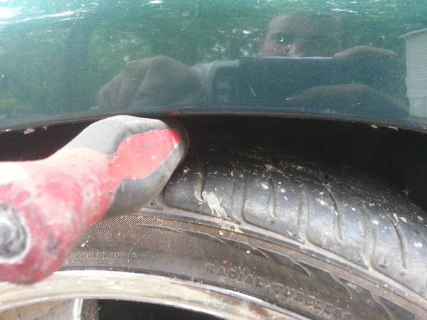

    Here's with new springs and they are 650s I found the part number

    She's a lot stiffer I got to get some stiffer shocks too to transfer weight faster because 1100hp is gonna be a ride in this little thing
