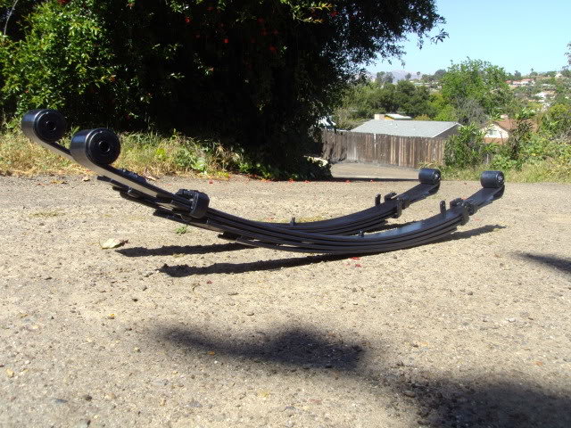

    My ears must've been burning haha. heres some 2nd gen springs I did for a member using his stock main & secondary springs with the TSB with the addition of 1 Ford spring...
    going to wrecking yard tomorrow for more springs to build 3 sets for members

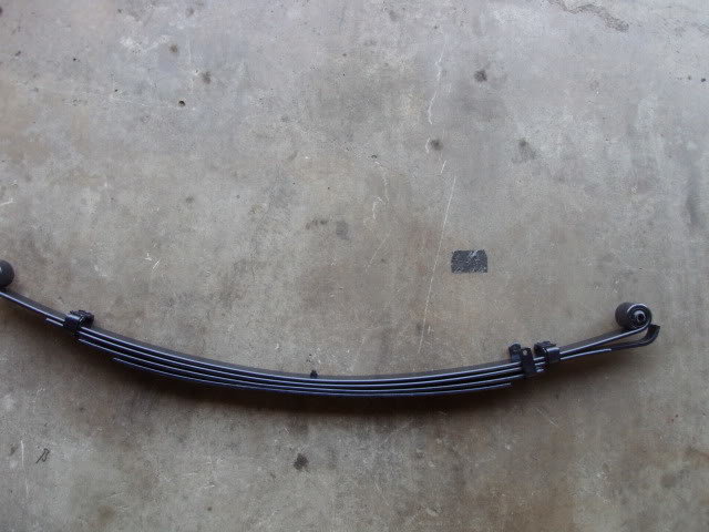

    These are my rebuilt stock leafs w/2 Ford springs per side
    3" gain in lift, fantastic performance on/offroad

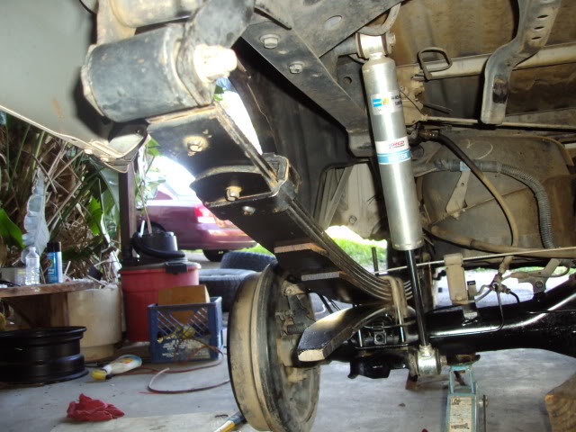

    Heres an example of good results, it doesn't look like much but here are some OEM 2nd gen springs w/TSB (AAL) & 1 heavy Ford spring per side, this set I put together for SoCal member ReCkLeSsTaCo (Matt) who drives his truck harder than most. After about a year of beating the shit out of them they still look like this....
