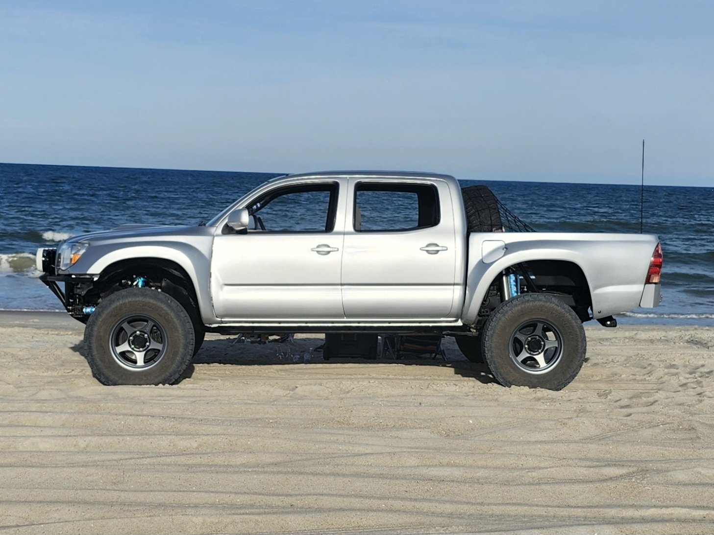

    Still thinking about this 2 years later. Wanting more rear uptravel for spirited beach driving. Already have 14 inch rear shock relocation (through the bed), hydro bumps, 4 inch rear archive shackle and hammer hangers with cross tube.
    I have no problem redoing the lower shock mounts to put them lower to account for the extra uptravel.
    I don't care about cycling 20" of travel, just want another 2 inches of uptravel to be able to not be bouncing off the bumpstops.
    Truck hauls air and I don't even have a trailer hitch.
    What's your thoughts on running a deaver light duty spring on this type of setup?

    With Deaver Light Duty (U644/645?) Mid Travel springs, you'll have zero lift, and therefore sadly the same bump travel.
