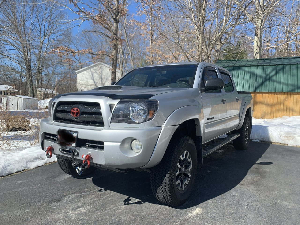

    I have a 3” rough country suspension lift
    I put in a hidden 75 pound winch bumper, and a 12,500 lb winch about 65 lbs
    Look at pic. No sag what so ever

    Awesome! Thank You, Looks Great!
