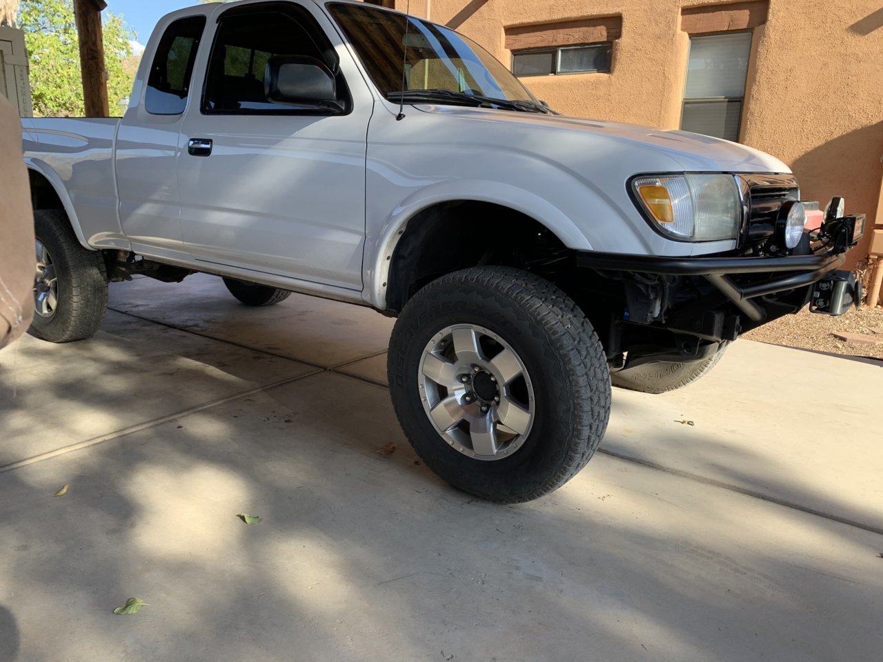

    AZLineman52
    AZLineman52 Member
    Nov 18, 2020
    #347079
    5
    2000 Tacoma 3.4 ex cab 4x4
    All Pro bumpers, winch, uca’s, bilstein, add a leaf and rear shackles
    I have new cooper 255 75 17’s. Measurement to fender lip is 39-3/4” pass, 39-1/4” dr. I think im gonna drop to position 2 or 3 and get 1/4 spacer for pass. Im 230 plus a full tank it will be more of a diff.
