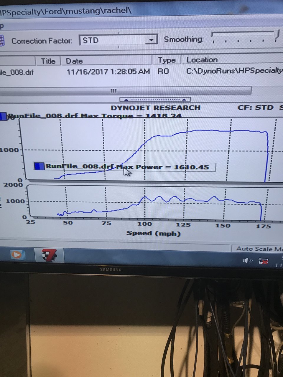

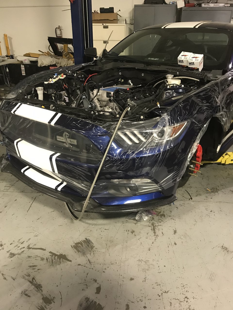

    First " I dont work for sprint booster " We as a shop sell them and have done extensive testing a trials with them !
    I get most think these dont work and are trash. Blah blah!! We use these on cars from Lamborghini to the 1300 Hp Shelby Super Super Snake we just built . And a few other cars like the AAROW C7 that we just rebuilt to one up Lingenfelter ( cause they couldn't keep from overheating ) for indy driver Sam Schmidt that just did 200mph as a quadriplegic . I get it !! I thought a little over a year ago just like everyone else """" Its snake Oil"""" .. I mean obviously having built the worlds fastest WRX back in the day , and a few 1500-1800 supras and been apart of projects where we built parts for the worlds first 100 hp Tundra and the worlds fastest SUV (toyota) , That i and my partners have seen it all! Till I gambled and tried it ! Now every car that we build that has drive by wire has a Sprint Booster!!
    Unfortunately some cant get the plugs fully connected on the TACOMA and that cause a issue .! But we've ran into that with a $13k motec on a race car !!! But weve tested these fully to insure that if we put one on a hundred plus thousand dollar car that safety cant be compromised !
    Were even doing one for a 1600Hp mustang that hit so hard off the line it almost flipped over!
    ***** NOTE THESE DO NOT MAKE POWER THEY MAKE IT SO YOU CAN USE THE POWER YOU HAVE QUICKER******IMG_2646[1].jpg IMG_2726[1].jpg
