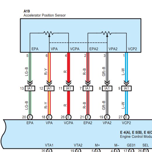

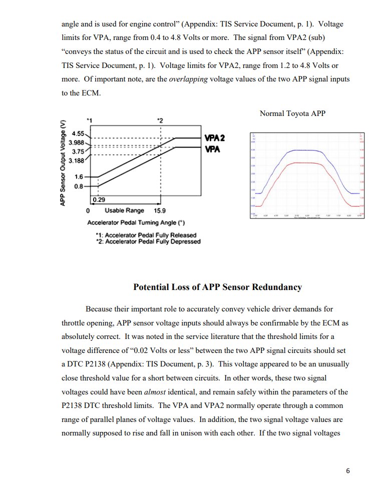

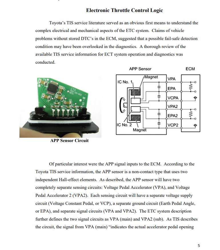

    This 100%.
    The drive by wire throttle pedals on these trucks are nothing more than simple 5v analog circuits. Putting a spirit booster / pedal commander etc inline only simulates the driver pushing on the gas pedal more or less then they actually are. It does NOTHING to change the speed at which the throttle blade can open (which is very fast unless the ecu is doing some sort of throttle management for traction control in which case a spirit booster wont do anything to change this).
    You could literally put an on off switch in the circuit instead of the gas pedal and the throttle blade would only open as fast as it could / the ecu allows.
