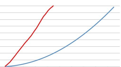

    my take....you only have to move you foot a fraction of the distance to get the response of "flooring it" (the larger the number the quicker to full).
    blue = stock
    red = sprint booster
    (non-technical chart, lol)
    so much so, that in any adverse road conditions i have do set it back to stock.
    TimC likes this.
