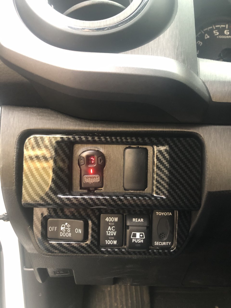

    Had the Sprint Booster on my 16 & 19 2.7's. Became a new truck for me. Throttle response became as I think it should have from the factory. Of course I know they do that to squeeze an extra MPG or two into their pamphlet. Got it in my 2020 3.5 now. In the 2.7's, I had it set for Sport #6. The thing I liked about the Sprint Booster was that once you find the setting you like, you can remove the controller and wire going to the module. If for some reason Aliens stole it out of my truck, I would order another the next day. Hope that helps you.
