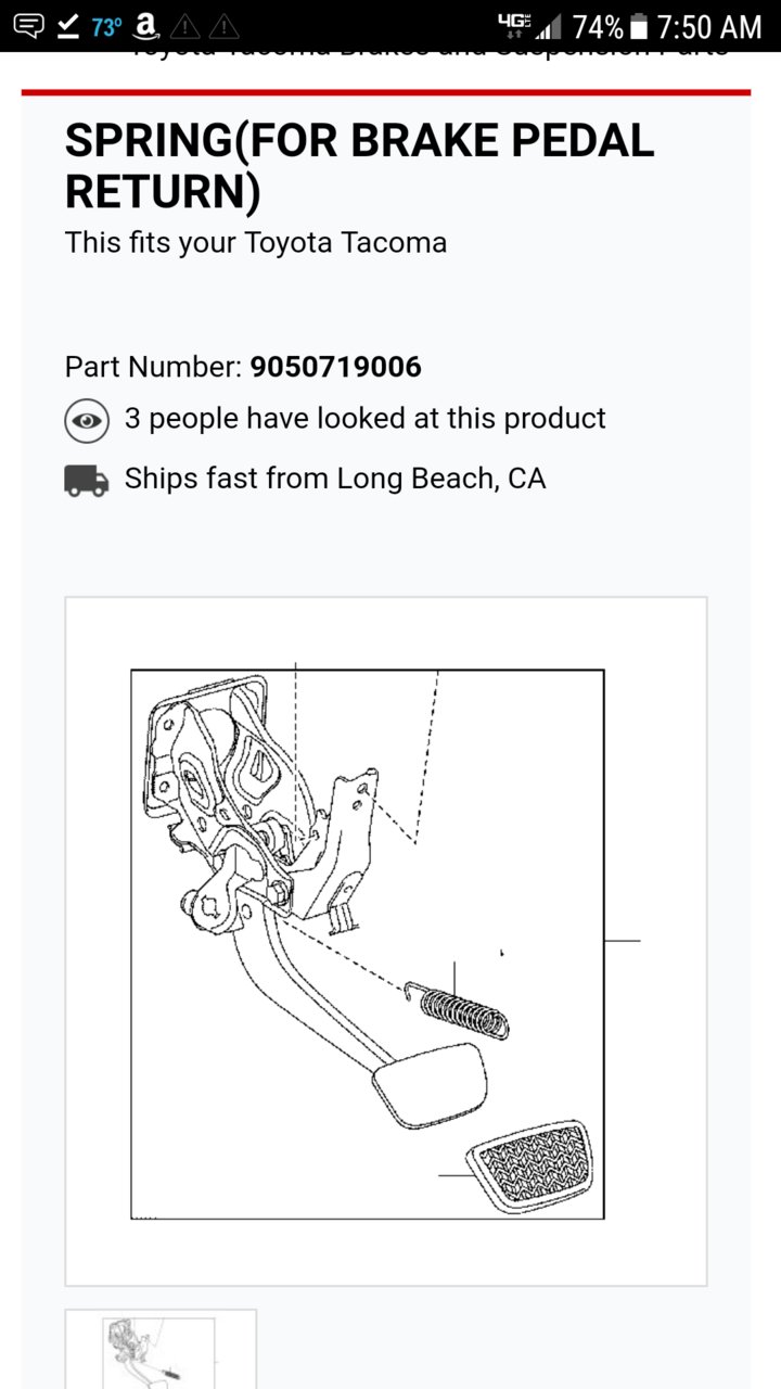

  7. May 12, 2018 at 7:51 AM
    #27
    Lord Humongous
    Lord Humongous The Ayatolah Of RockNRolla
    Jan 14, 2016
    #174960
    2,317
    AZ
    Inferno 3rd gen trd offroad 4x4
    https://www.tacomaworld.com/threads/lord-humongous-gigahorse-build.436524/
    Seriously though maybe the return spring is catching on something?

  11. May 12, 2018 at 3:25 PM
    #31
    riverrockar
    riverrockar Well-Known Member
    Jun 6, 2017
    #220819
    244
    Indiana
    2017 Tacoma DCSB TRD Sport INFERNO
    OK, just got home from the shop to install my sumo springs. I peeked around by the pedal assembly, and found the spring shift around due to changing angles when you push the pedal. There appeared to be a small amount of white lithium grease on the hook of the spring, but not much, and it seemed a little hardened up. I lubed it up with some synthetic caliper slide grease, and the noise went away. Super easy fix, for now at least.
