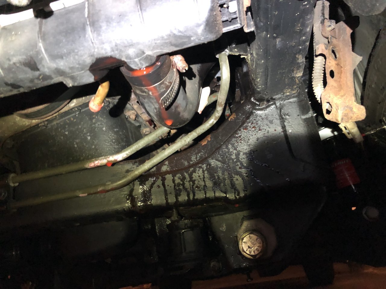

    Stopped for gas this morning and noticed my taco was bleeding. A small pool of coolant leaking from what looks like the lower hose where it connects to the radiator. I hope it’s just the hose. Decided it’s a good opportunity to upgrade to red reinforced silicone hoses.
    Since it was cold outside and it wasn’t gushing out, it didn’t overheat. I drove it back home and drove my backup vehicle, the boring ol F150

    Check that that worm gear hose clamp is not loose (it is not oem). They are not bad, I always replace oem clamps with worm gear clamps, but they must be checked for tightness about a week after initial tightening. It’s not that they get loose, it’s that the material they tighten may compress. It is also possible the radiator is what’s leaking.

    I assumed it’s OEM. It came to me this way. The radiator system is one of the few systems I haven’t touched yet on this truck aside from replacing the coolant. I never touched that hose/clamp before. I already ordered some new hoses and clamps anyway so I’m going to wait till they arrive before I go messing with it all. If it is the radiator that’s leaking I’ll replace that next but at least I’ll have new hoses with it.

    I was just wondering cause toyota doesnt use those clamps...

    Makes sense when I think about it. In hindsight I didn’t examine the problem too deeply or pay enough attention to those kind of details

    May just need tightening..

    Most OEM's don't use worm clamps. Take a look at this article to get a better understanding of why.

    Plus new coolant haha. I just parked it and put a drain pan under it and rushed off in my other vehicle. :anonymous:
    it probably drained all day

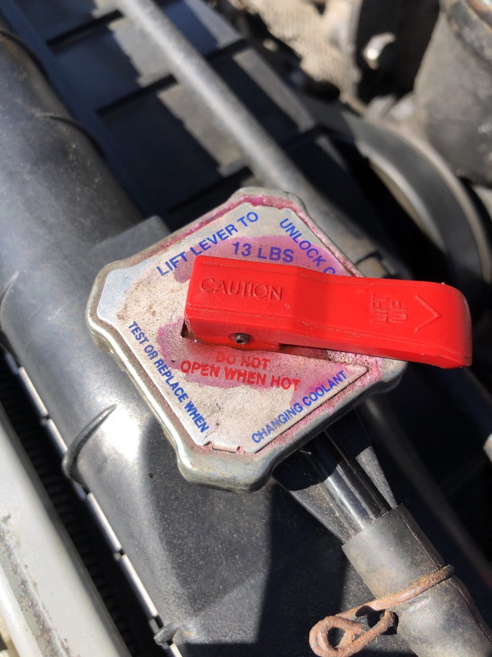

    It looks like it was just loose hose clamps at both the top and bottom of the lower hose, like you said. Cinched em down, topped off the coolant and didn’t see any leaks. It didn’t actually lose but a few ounces actually. Took it for a test drive and it never exceeded 181 degrees. Same as before the leak. Now, I do see some seepage at the radiator cap, do I just need a new cap?

    good deal...yeah looks like it needs a new cap.
