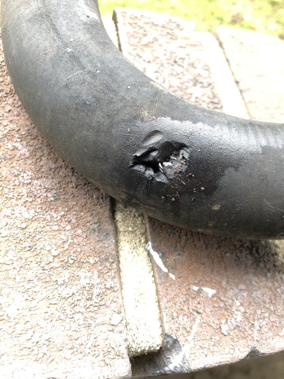

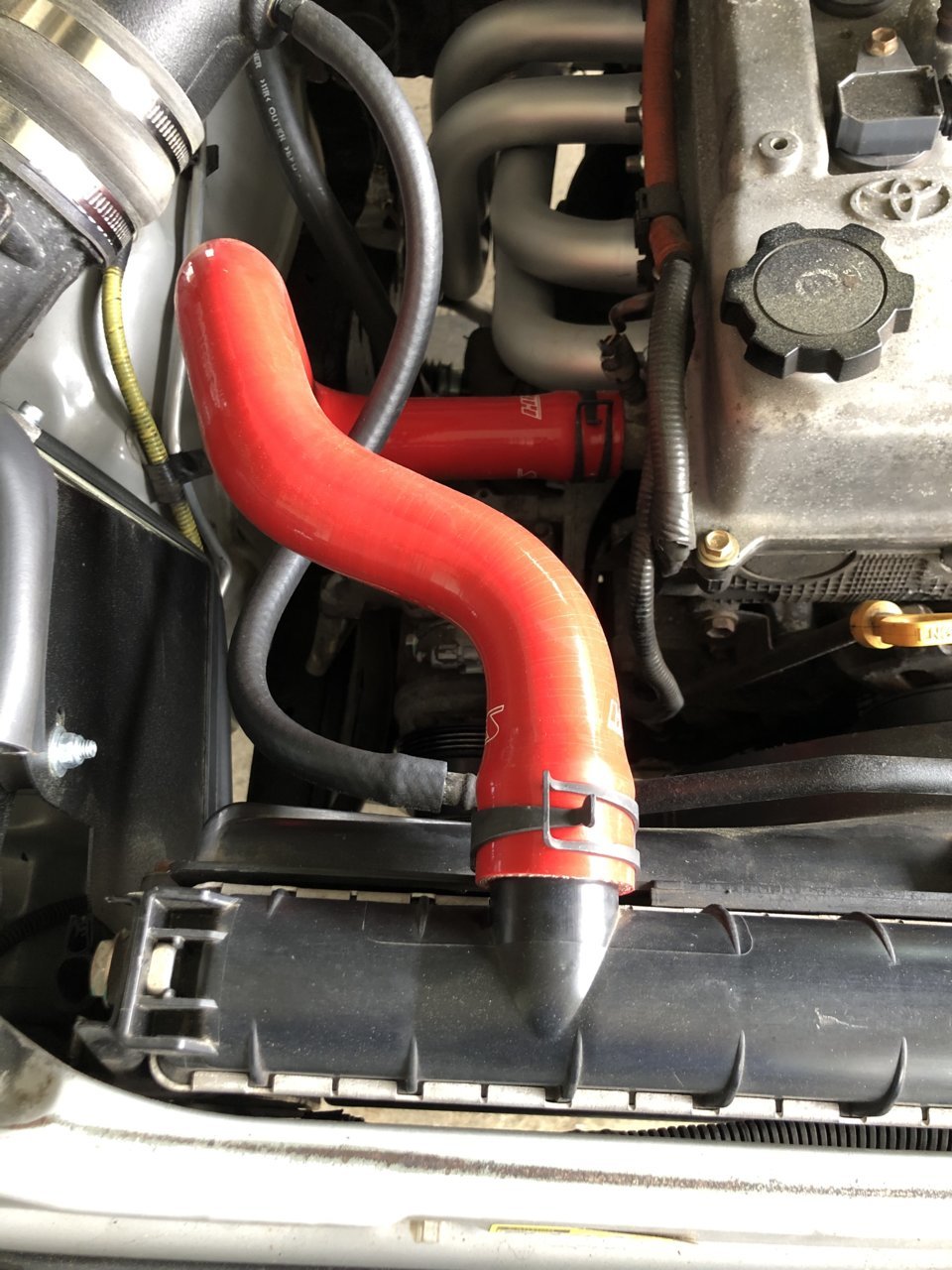

    Found the actual source of the leak. The battery wire harness anchor bracket rubbed a good chunk out of the drivers side hose and made a puncture. Replaced with HPS silicone reinforced hoses just because. Used OEM spring clamps.
