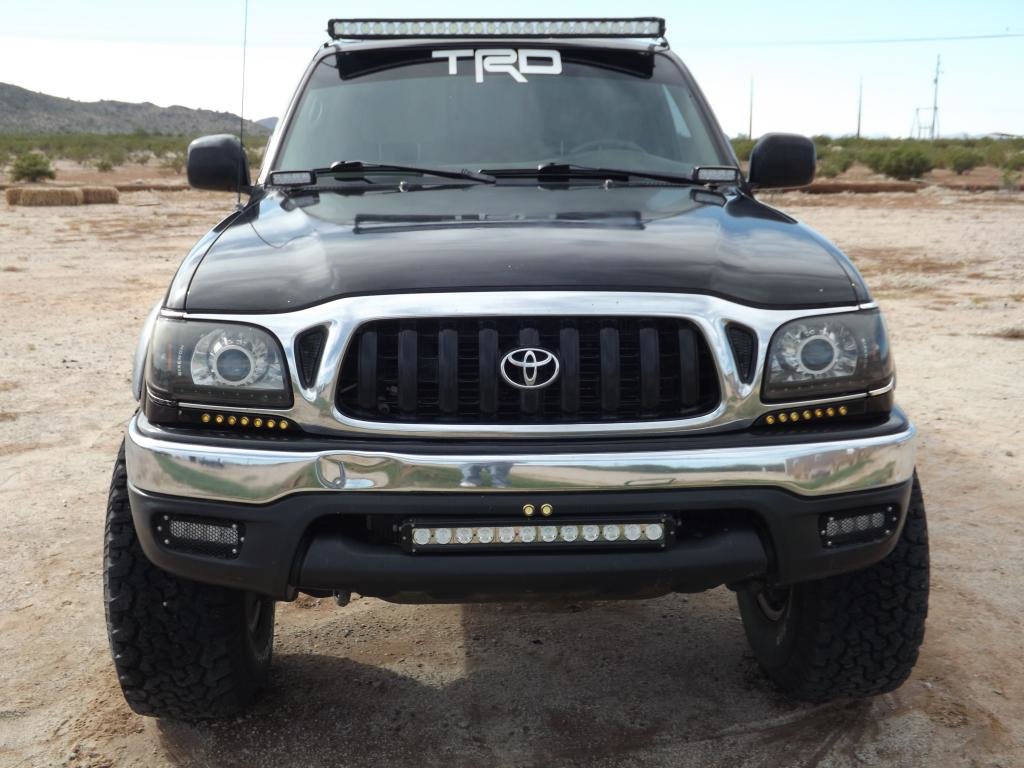

    I used something like this. I currently have all of my grill lighting powered from the parking light circuit.

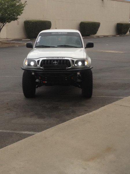

    Projectors are the best of the best. Even the cheapest ones TRS offers like the mini's throw out like, 100% more light:D
    I don't have any shots of high beams, but here's one I found of the low's with the mini H1's.
    But lets not get carried away here. There's all kinds of info out there for projectors in other threads. Check out Hidplanet.com too;)

    Finally got around to wiring the LED lights to my parking lights. I'm happy with the way it turned out.
