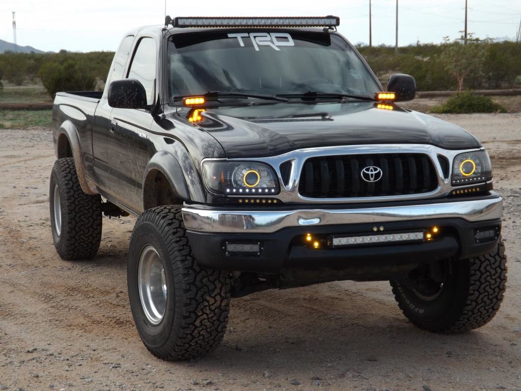

    These type?

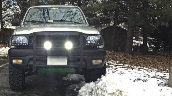

    The first time I got these I got them from eBay water leaked in and ruined them the company I got them from were nice enough to send replacement, but 2 months later water leaked in again That was a year ago. I ordered them again in October 2014 but this time I got them from CarID and paid a lot more then before almost $300. So far they have not leaked and the light quality is not bad. The rubber garments feel a lot tighter then the ones from eBay and the corners of the of the headlights are better sealed then the ebay ones. CarID has lowered there price in the last 2 months from almost $300 to $175.

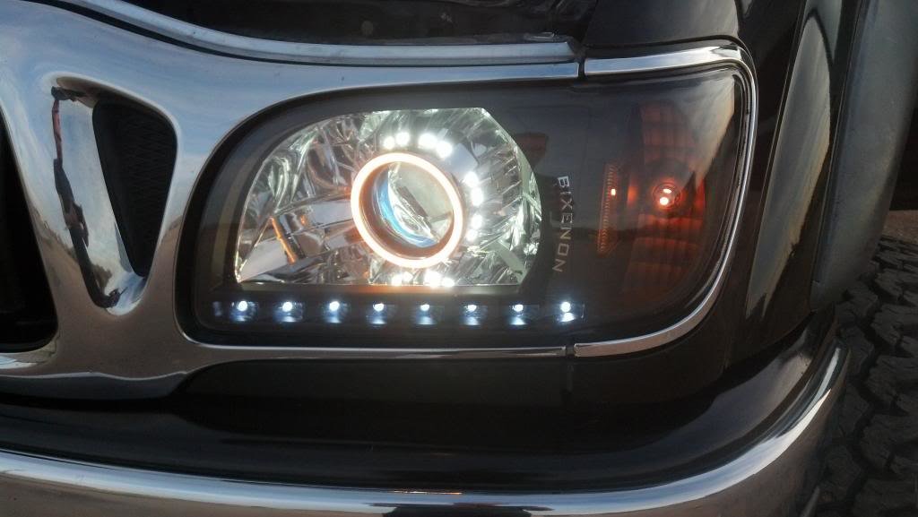

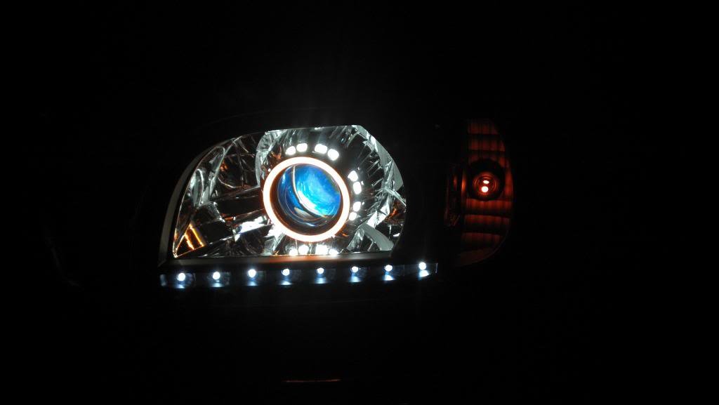

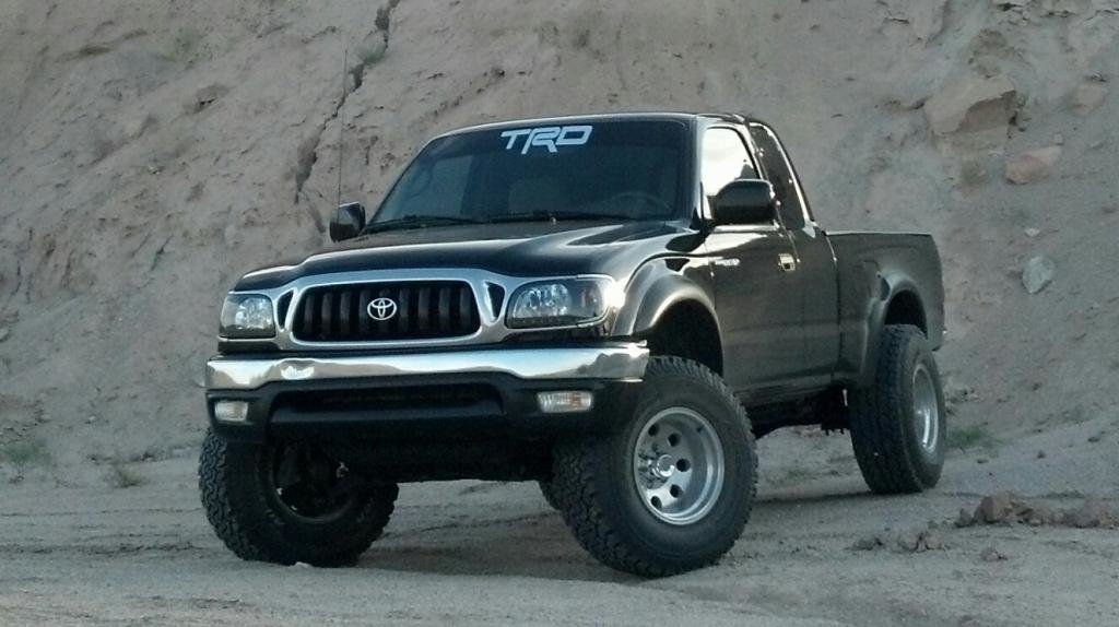

    Hmm. Yeah I wondered if the US retailers sold better quality ones and if the eBay are just cheaper knock offs. Or if it's just hit or miss with these headlights. Mine were packaged in with the spyder branding though. So Idk. But yeah I did not buy them from online retailers because of the $300 price tag. Maybe I'll take the plunge one more time with these if my new set ever fails on me. I also see that they have a 90 warranty. Versus the eBay ones which don't, just a range of 14/30/60 day return.
    But if you really don't wanna hassle with them, don't get em. I just like the look especially with a retro..

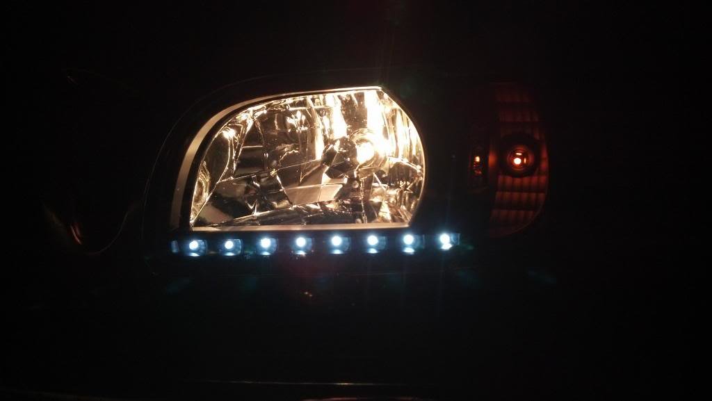

    Here a few before/after pics. The 'evolution' of my headlights through the years using the spyders, heh.
    Halogen
    Mini H1's

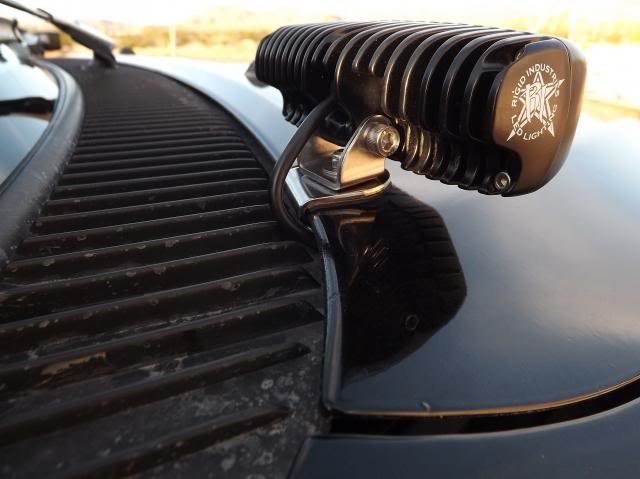

    What did you use to mount the LED Lights on the hood? I've been trying to do the same but with some Dually - Floods. Nice mod to the Spyder headlights they look sick.
  13. Feb 9, 2015 at 1:46 PM
    NightProwler
    NightProwler Well-Known Member
    Nov 12, 2013
    #116470
    3,522
    Harlan
    Maricopa, Az
    '01 Prerunner, '16 trd4x4, '03 cbr954rr, '03 rc51
    A universal antenna fender lip mount on eBay. You have to get different bolts with a countersunk head, and short ones at that, and the bolt installs upwards versus downwards.
    Or u can get cbi ditch like brackets. Which I just I installed too but for bigger led cannons. Pain to install though. The antenna mount was super easy. And is super sturdy for small lights like those. And cheap. I can find the link if u want.

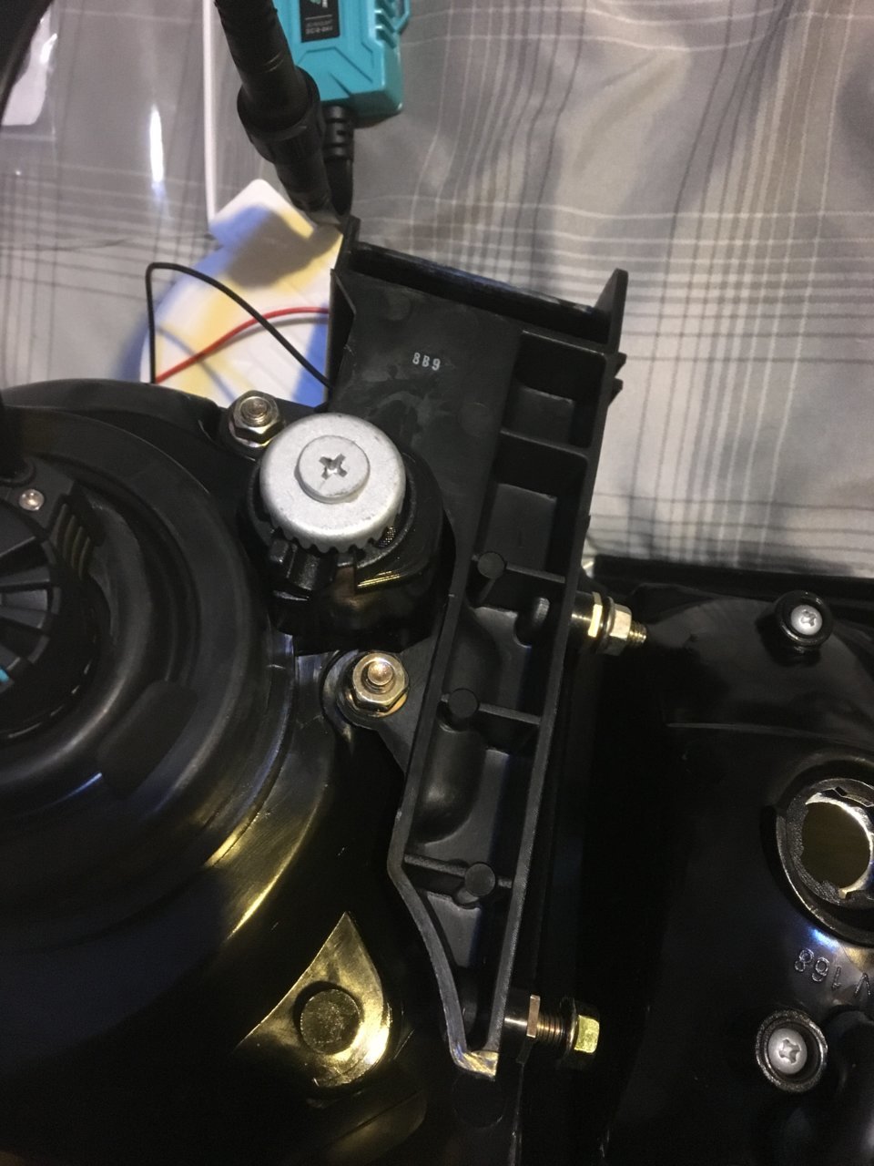

    You install the brackets onto the truck first. Then the headlights go into place and the studs insert into those brackets.

    Is it this bracket?
