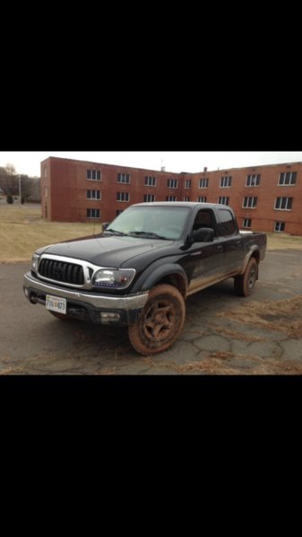

    I have the spyder headlights and one of my hid dual filaments is out I went to my local auto store call spyder and I cant find a bulb to fit

    You probably just need an H4 plug and play bixenon bulb, but make sure it at least has glare shields if you don't plan on putting projectors in anytime soon.

    Yes it sounds like he meant to say 'bixenon' hid. not dual filament. Is this what it looks like? If so, you can order some on eBay pretty cheap, or on Amazon preferably. You won't find any at the local auto stores. And beware, these housings are not retrofit friendly. They are prone to internal parts breaking with the added weight of the projectors. Ask me how I know.
