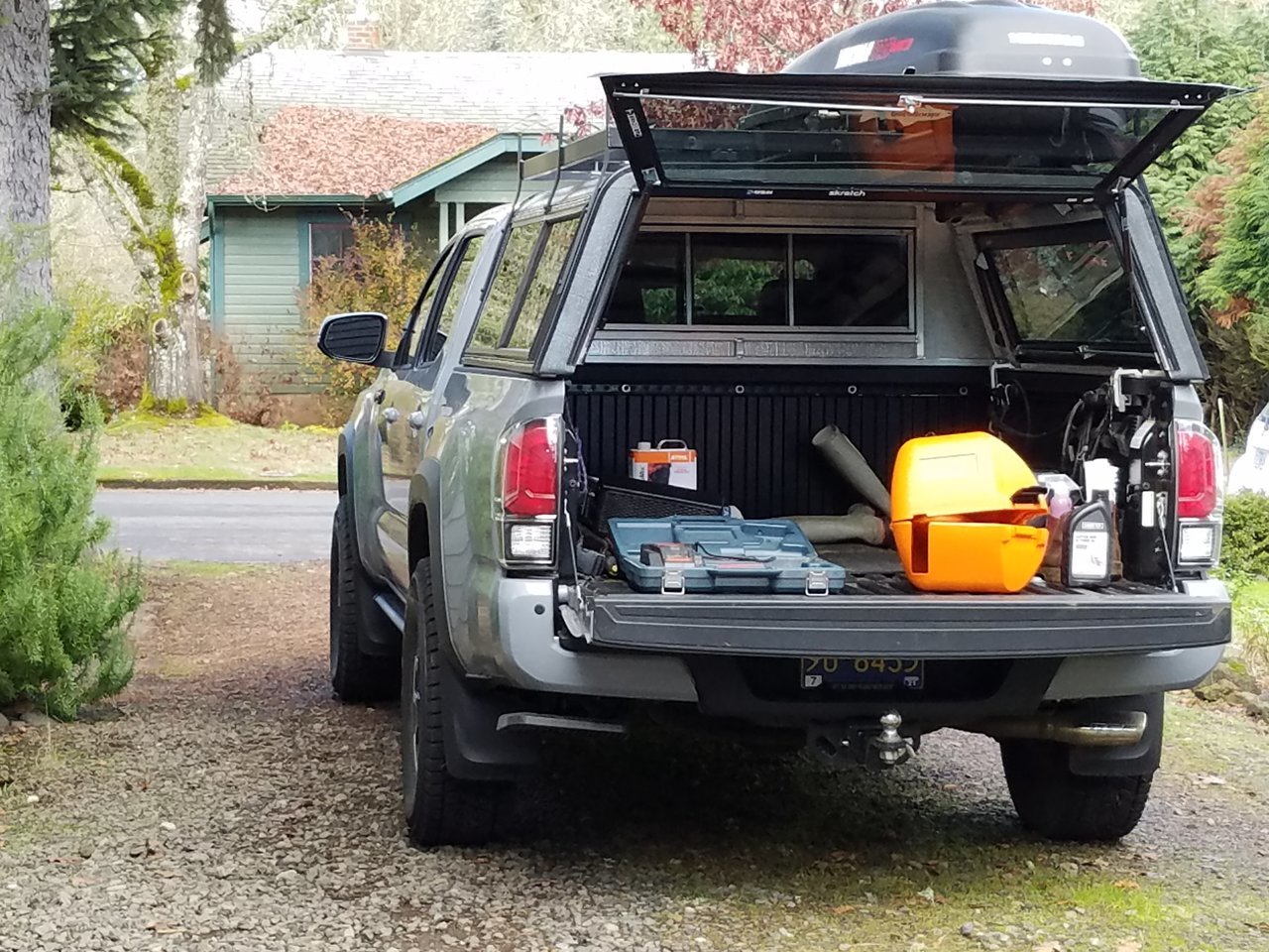

    This is what a 2017 TRD Pro Looks like when adding 1.25" Spyder Trax Spacers when running 2017 TRD Off-road wheels with 265/70r16 Blizzak Snow Tires. The 265/75r16 Dura-Tracs get mounted on the stock TRD Pro wheels in 2-days. I'll post a pic of what the Pro wheel offset does than. By the way. I've only driven about 20 miles with the spacers. I think it actually corners a bit nicer. Hate the fact that in the back of my mind spacers can come loose. We'll see if the nuts have budged when I mount the other wheelset monday night.

    I know, I know. I actually don't like the thought of spacers but...The off road wheel set was sitting so far in my wheel wells it was driving me crazy. Luckily I have a hoist and I can yank my wheels to check torque easily. If the Pro wheels with duratracs stick out too far I'll just use the spacers for the Snow tires. I do like the stance of how it looks with the spacers and snow tires. The bottom line is, Spydertrax doesn't just make spacers, they actually use them on rigs that go thru the elements. In theory if you do a good job installing them they should stay put. Not a fan of using red lock tite on wheel studs but you gotta do what ye gotta do.

    I ran 1.5" spacers on my 2015 JK and I drove the crap outa that thing off road. Never had an issue. That jeep even had a scary rough country lift so many people here hate too.
    Hub centric spacers and red loctite on the fastners and your GTG.

    Ran 1" hub-centric spacers on my last 2 Jeep GC's over a number of years with exactly Zero problems.

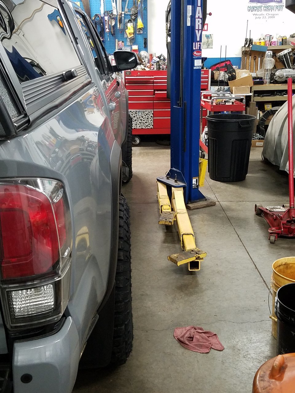

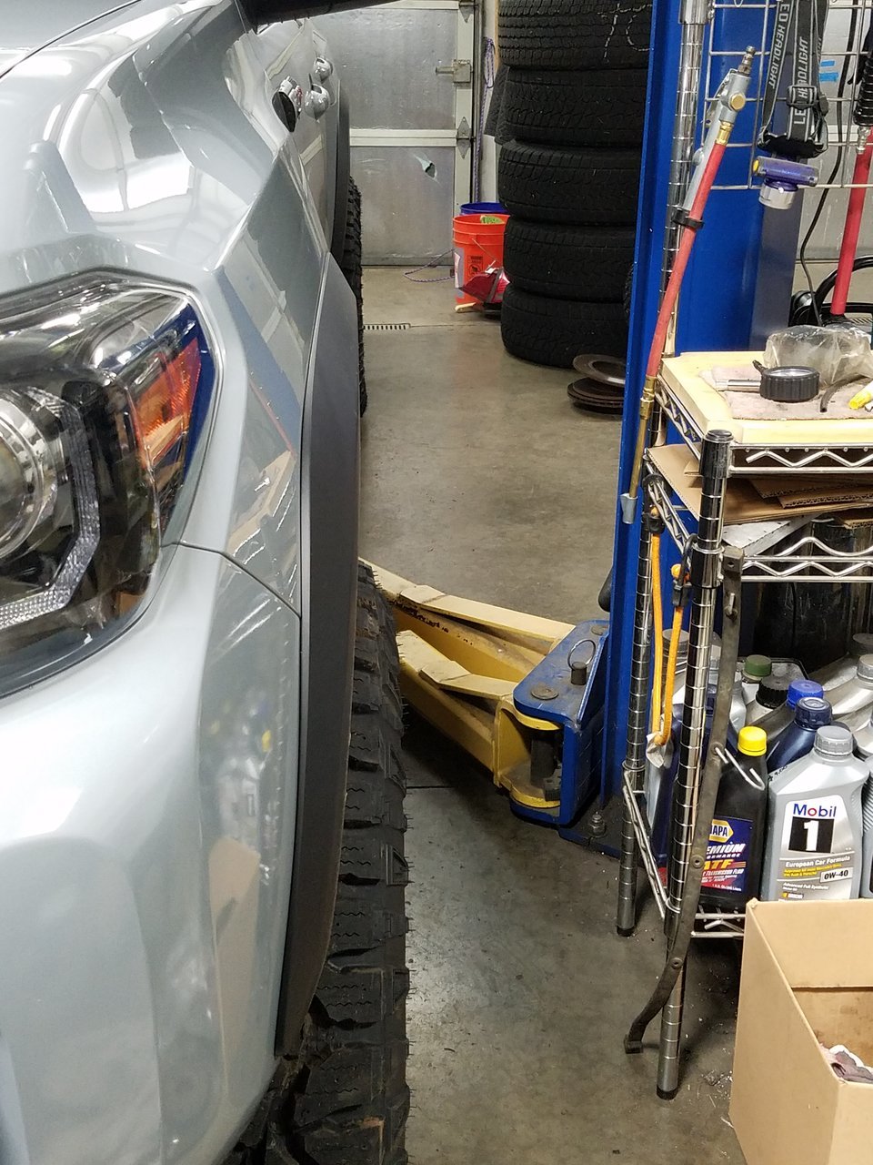

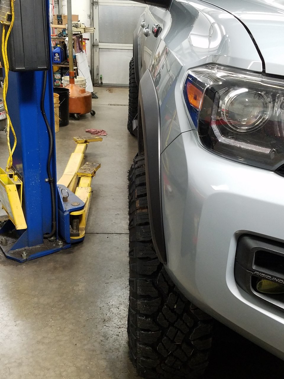

    Here's the Spyder Trax 1.25" with Stock Pro Wheels and 265/75/16 Dura-Tracs. Yes, it rubs the front Mud Flaps when I pull in and out of driveways with the wheels turned. I swore I read a million posts saying you could run 265/75/16 on a Tacoma Pro with No issues (No Trimming). Well, Mine rub. Makes me REALLY glad I didn't order the 285's!
