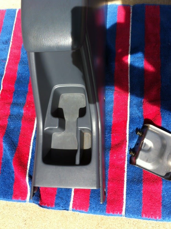

    I know...it seems like a silly question...so don't hurt me! [​IMG]
    Does anyone else have those ridiculously dumb square cup holders on their Tacoma? I know a lot of you are pretty good at coming up with neat solutions, so has anyone found one to make these things useable? I'm thinking about getting those squishy beer coozy things to stick in there to make it more solid but would like something more appealing. Is there something I'm missing from factory that I don't know about to hold things in better?
    For those of you who don't know what I'm talking about, I'll see if I can try and get a picture later. I just have to clean it up a little because it has drinks spilled all over it (I wonder why? :rolleyes:).
    And thanks for putting up with the silly question.

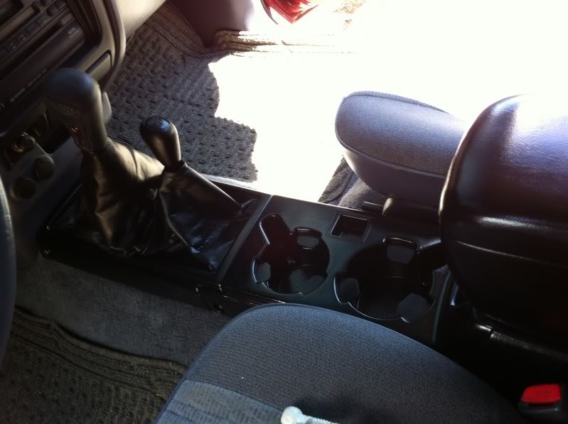

    The only thing those cup holders can effectively hold is chinese take out.
    Scour the Internet and forums to try and find an 01-04 assembly. It's the best upgrade to my truck so far

    One of them has a slight circle in the side of one...which kind of offends me! Haha. Toyota never been good with cup holders. I hated in our 96 Taco how it was in front of the stereo and the pop up one on our 02 Tundra always breaks.
    Thanks for the help everyone. Do you need the entire assembly including the shift cover and center console? Di you have a pic of yours Nadjik?

    You can keep your shift trim, the 01-04 will line up perfectly with it.
    All you need to get it the 01-04 cup holder/center console assembly and the bracket that attaches it to the body. The holes in the 01-04 bracket line up perfectly with the holes in the 98-00 body.

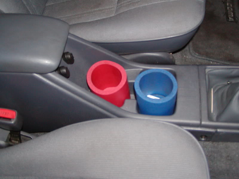

    1,381
    SoCal
    '00 Tacoma SR5 4X
    Donahoe CO's, Deaver leaf paks, Lockright Locker, All Pro body armor ( sliders, front and rear bumpers ), All Pro under belly skids, Warn M8K w/Masterpull synthetic line, Dual Optima battery system, 4 ea LightForce Striker 170 offroad lights, 8 ea wired rock lights, and plenty more I'm sure
    holds mine... maybe you need a different cup ;)
    I use a stainless double wall cup...
    but I kept forgetting to take if off the tire before driving away :facepalm:
    so it has a few dents, scuffs and the handle broke off :(
    but the lid still seals... so it's still good :p

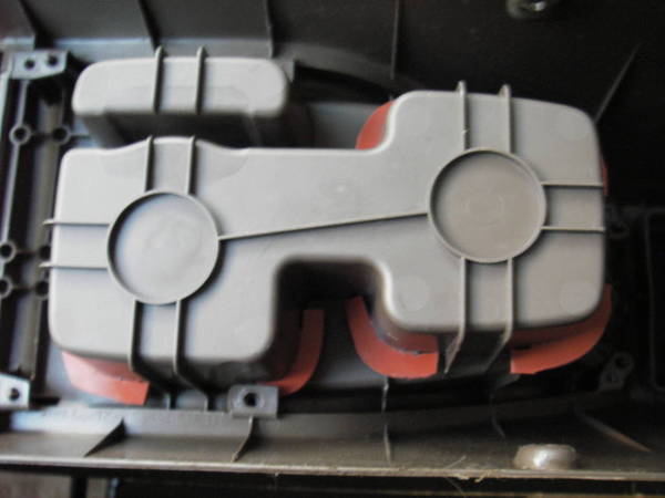

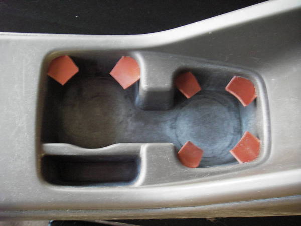

    I finally took the square cup holder matter into my own hands. I took inspiration from the 01-04 cup holders, but I didn't want to have to actually buy the cup holders, because I think buying used pieces of plastic is a bit silly, but that's just me.
    A replacement for broken rubber tabs that some here have mentioned is 1/8" rubber plumbing gasket material, and I thought that would be a perfect "finger" material. I took a mini hacksaw, drill bits, an X-acto knife, and cut notches into the corners of the squares, rounding out the holes. I couldn't find any black rubber, even after checking Ace, Home Depot, and Lowes, so I had to resort to red. :-(
    Here's a finished pic:
    I just finished it last night, so I haven't installed it yet, but I can hold it upside down (on the rear, 4-finger holder, at least) with a bottle of water, and it won't let go.
    As of now, I'm thinking the pitiful size of the center console compartment should be remedied, so in the future I might just replace the whole damn thing anyways...oh well.
