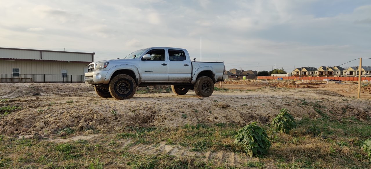

    My educated guess is that the truck handles better with more of the bias towards the front vs rear.
    I drove around with a bit of squat before my leaf pack came in and noticed that the steering feels very "light" on the highways or during acceleration.
    After leveling and keeping the factory rake, the handling "normalized"
    Old picture right after I finished the suspension:
