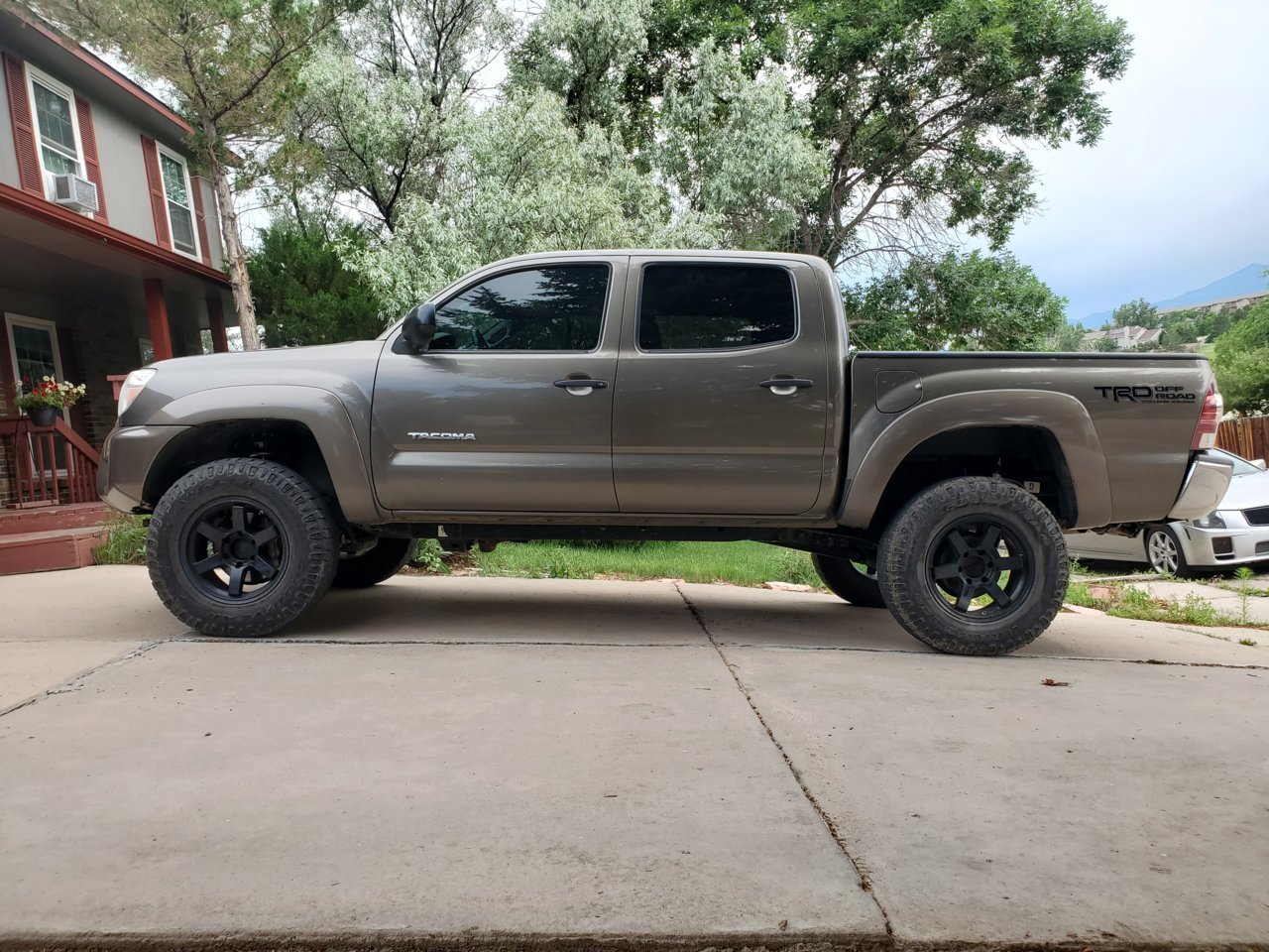

    JayRolla
    JayRolla Well-Known Member
    Mar 30, 2017
    #214833
    2,887
    Jason
    Colorado Springs
    Wife's 2012 DCSB Tacoma Sr5
    Trd stickers for 10whp 32s on MK6 17s
    So when you add weight the rear don't sag. Also if the leafs start to wear they won't sag. Toyota learned there lesson years before when consumers started complaining about sagging rear ends.
    Also helps offroad by helping the rear not drag so much.
    will.i.was and wiljayhi[QUOTED] like this.

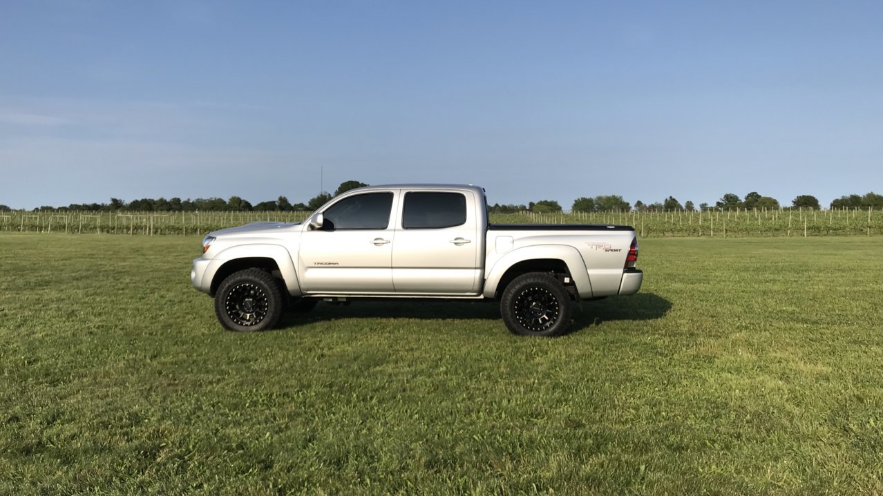

    bigdawg01
    bigdawg01 [OP] Member
    Jul 6, 2017
    #223293
    9
    2005 Silver Tacoma TRD Sport 4x4
    As I said previously, I did this when I was 18 years old. I just wanted it level, saw leveling kit, thought "damn that'll work." Didn't take into account that the leaf springs were 11 years old and probably sagging. Obviously made a mistake, trying to fix it now, as I feel like the sag is more noticeable now than it was previously (probably due to further age on the leaf springs as well).
  4. Aug 11, 2021 at 1:13 PM
    #24
    JayRolla
    Mar 30, 2017
    #214833
    2,887
    Jason
    Colorado Springs
    I'm a fan of the stink bug look. Lol. Helps a lot offroad.
  5. Aug 11, 2021 at 1:23 PM
    #25
    will.i.was
    will.i.was Well-Known Member
    May 6, 2018
    #252688
    1,679
    Will
    Houston, Texas
    SC 2.5
    Clean rig! I like that rake. Mine is more level now due to all the broverlander stuff I added

    #26
    Wattapunk
    Wattapunk Stay lifted my friends !
    Jan 26, 2010
    #30098
    4,075
    Uncle K
    TX
    2005 DCLB 4WD
    OP, I can assure you that your original 2005 leaf springs are sagging due to age. Unless your truck had a leaf spring recall, it may have 3 or 4 original leaf pack. If you don't want to spend $$ on a whole leaf pack replacement, go with a wheelers progressive 3 leaf aal. Avoid blocks at all costs which can accelerate sag, promote axle wrap and does nothing performance wise for payload capacity.

    #27
    bigdawg01
    Jul 6, 2017
    #223293
    9
    I’m looking at getting complete new leaf springs right now and leaving the leveling kit on.
    I took it in for that recall hoping I would get new leaf springs out of it, I came out with the same old leaf springs and an entirely new frame about a month later
    beignet, JayRolla and dirtnsmores like this.
  8. Aug 11, 2021 at 6:08 PM
    #28
    Wattapunk
    Jan 26, 2010
    #30098
    4,075
    Uncle K
    TX
    2005 DCLB 4WD
    If you are still on the original stock coils, I would remove the front spacers and save up for a set of adjustable CO's. Avoid spacer and rear block lifts.
    dirtnsmores and bigdawg01[OP] like this.

  10. Aug 13, 2021 at 3:41 PM
    #30
    TACOMA2NDGEN
    TACOMA2NDGEN Well-Known Member
    Jan 24, 2018
    #242230
    1,990
    ROLAND
    new jersey
    2010 dcsb silver sport trd
    baja squadron pros
    Depending on how much squat you have. You could always remove your trailer hitch if you have one or the spare tire . I wouldn’t recommend that. But i had the leaf spring recall done and it dropped my rear about 1/2 inch. My hitch was so rusted I removed it and it leveled it back out
