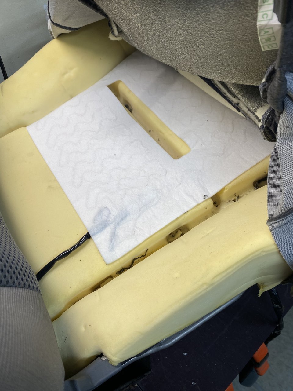

    Added Dorman Seat Heaters and a Blue Sea System 4V constant power USB quick charger. I only got one side (driver) done on the heaters because it was so hard. I’ll probably tackle the other side next weekend.

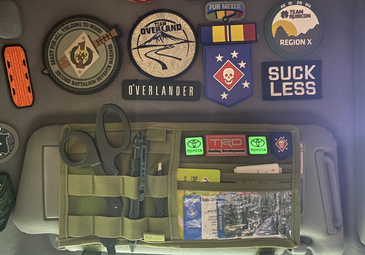

    Popped on a Molle Sun Visor organizer I found on Amazon.

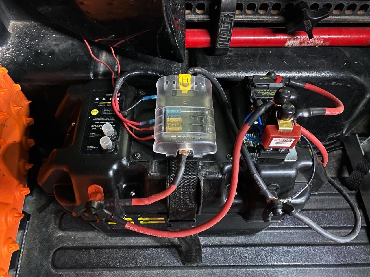

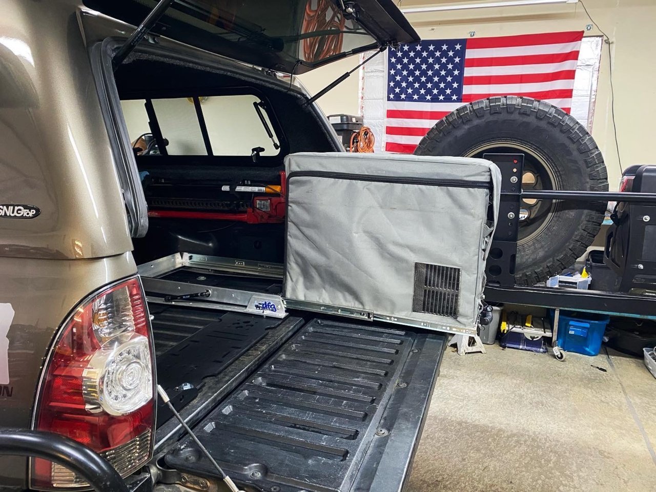

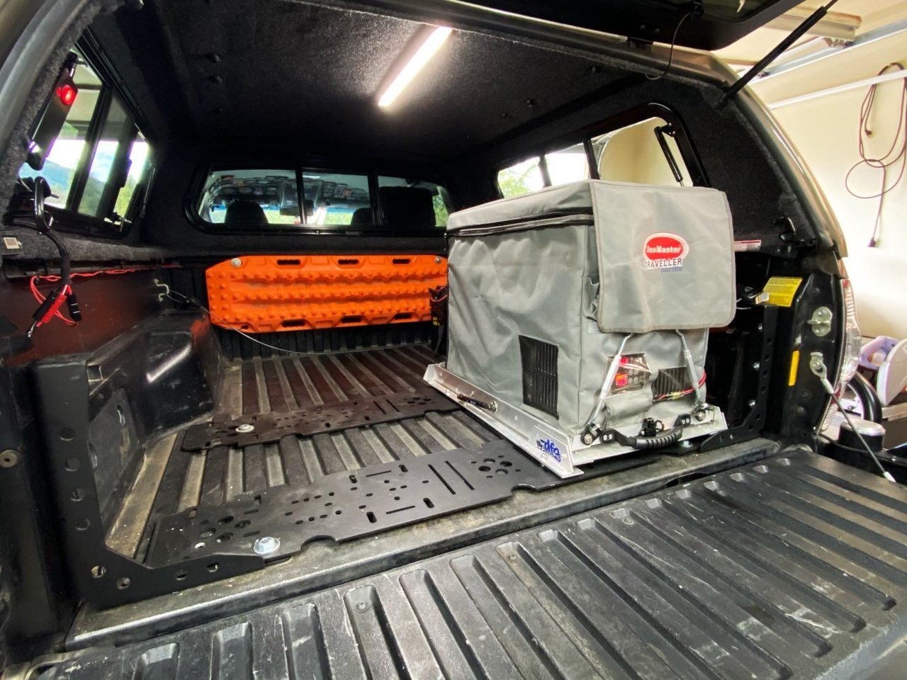

    Added a dual battery to power the Snomaster 12v fridge on DFG Off-road Slide. Also using the dual battery to run some accessories off the constant power like the canopy light and probably some other stuff later on. I used a trolling motor battery box, a Redarc smart battery isolator, busman circuit breaker, and a Blue Sea fuse panel.

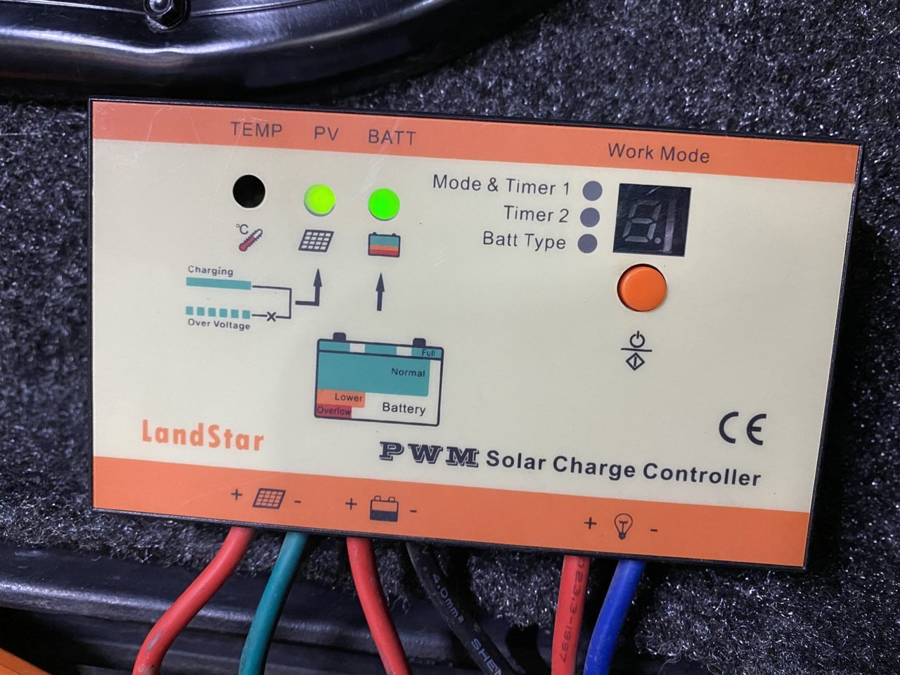

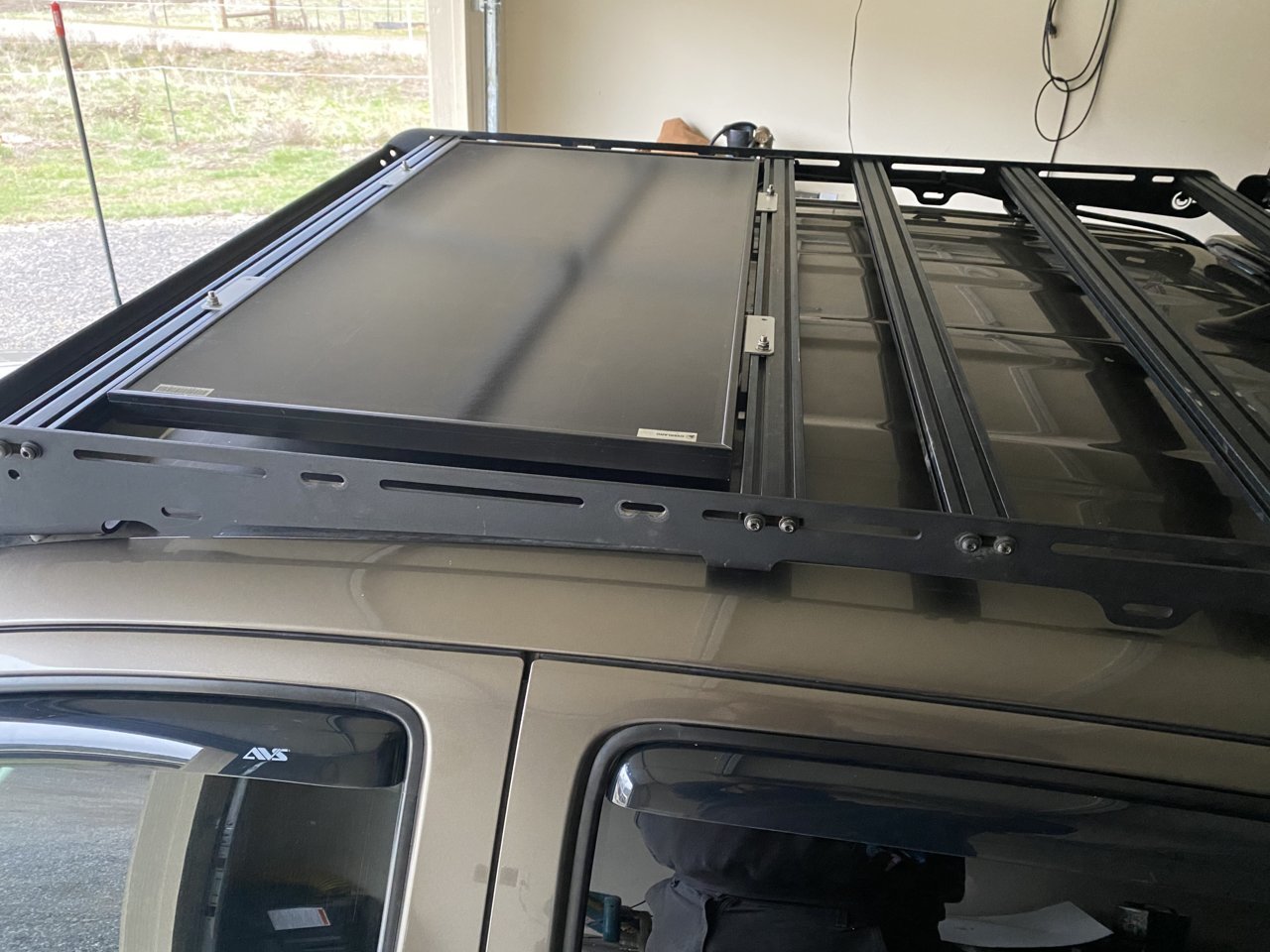

    Added Overland Solar 100W panel and Landstar Solar Charge Controller
    A8A103F6-C148-4EDA-B95F-50B364646879.jpg 324ECB90-BB23-47AE-A6ED-D30C929FF5AF.jpg

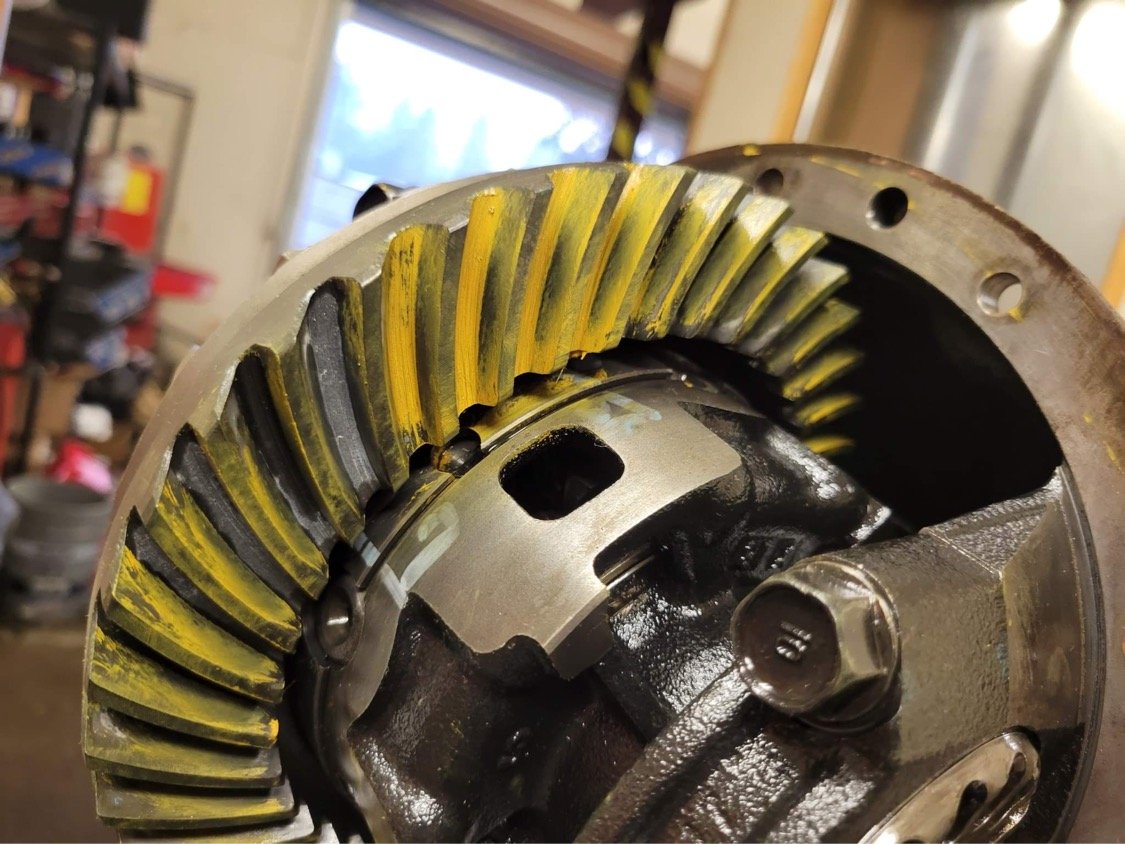

    Installed some 4.88 gears. Had to run Sierra up front and Yukon in the rear because that is what was available.

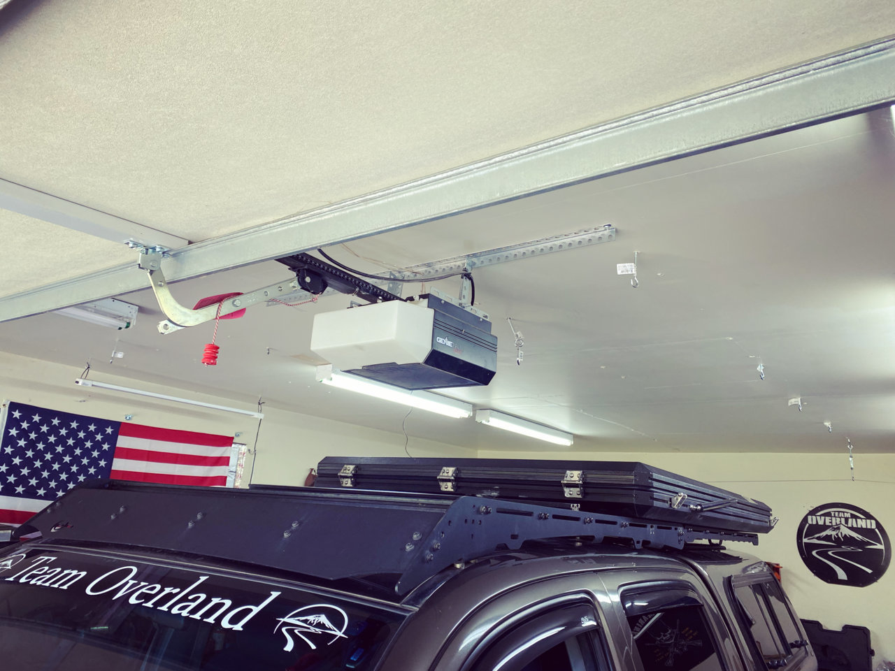

    New Outer Tents Osprey Slimline Aluminum Rooftop Tent that barely (by one inch) fits in the garage!

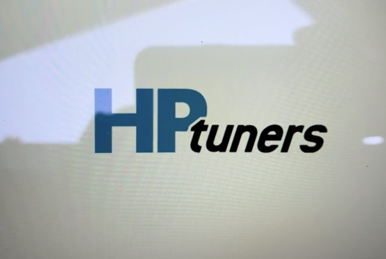

    HP Tune using Overland Tailor Tuning custom supercharged calibration.

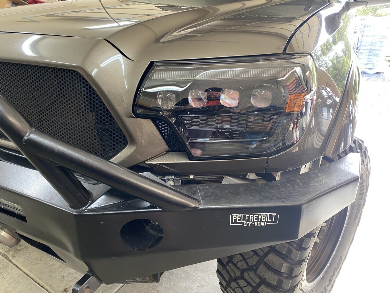

    Alpharex LED Headlights

    No more retros? I’m actually in the process of building some retros but I’ve had my eye on some of these alpha Rex headlights

    No I ditched them. The seals gave out and kept burning bulbs. They didn’t seem well retrofitted to begin with and didn’t want to deal with it anymore. The Alpharex lights are incredible and now one of my favorite mods. They’re 10x more road light than my retrofits ever gave off.

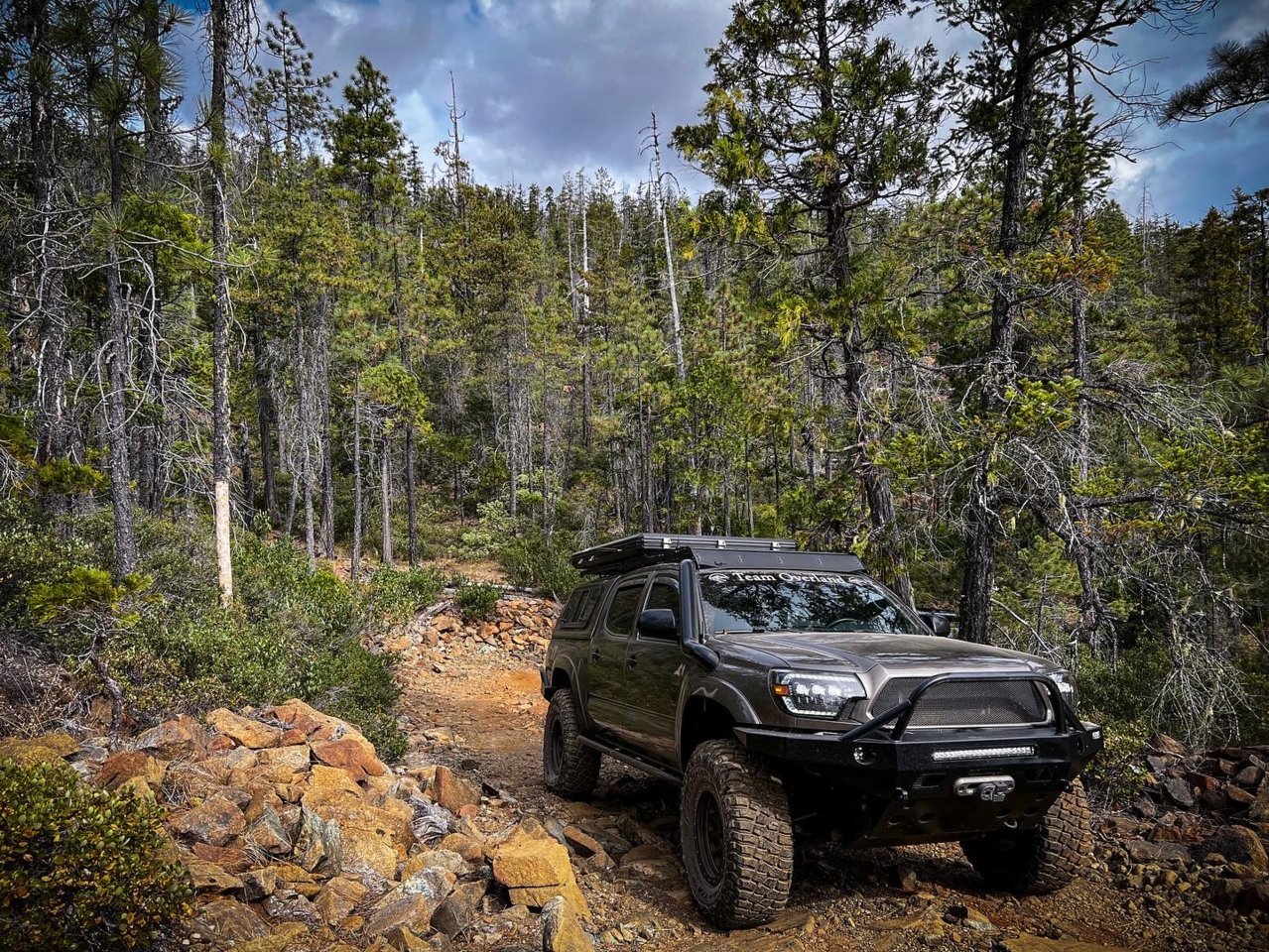

    Finally got out and used the Tacoma for what it was built for! The McGrew trail did not disappoint!
