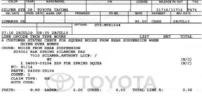

    Not saying this is your problem, but this is what mine was. Annoyed the crap out of me for a year before I let the dealer check it out. Hope this helps.

    Crap, so much for just 'hosing' them down with the rattle can. I wanted to do this TONIGHT! If I need to jack up the truck and separate the leafs it'll have to wait to tomorrow, or even later.
    Murph: Since I have swapped the shocks and added the Toytec AAL my dealership won't even consider looking at the suspension.

    That's why I posted the slip in case you wanted to order the part. When I picked up my truck, the service manager was pretty honest admitting they have had failures of these pads. Yours is newer so it may not apply - worth checking this just in case.

    @Murph: thanks for the post. I saved it.
