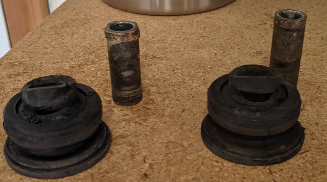

    hmm...do you have a picture of the core support mounts?

    No, they have been mostly under warranty and we have to turn them back into the parts department.

    These were mine:

    ^ That's what they all look like, that I have replaced.
