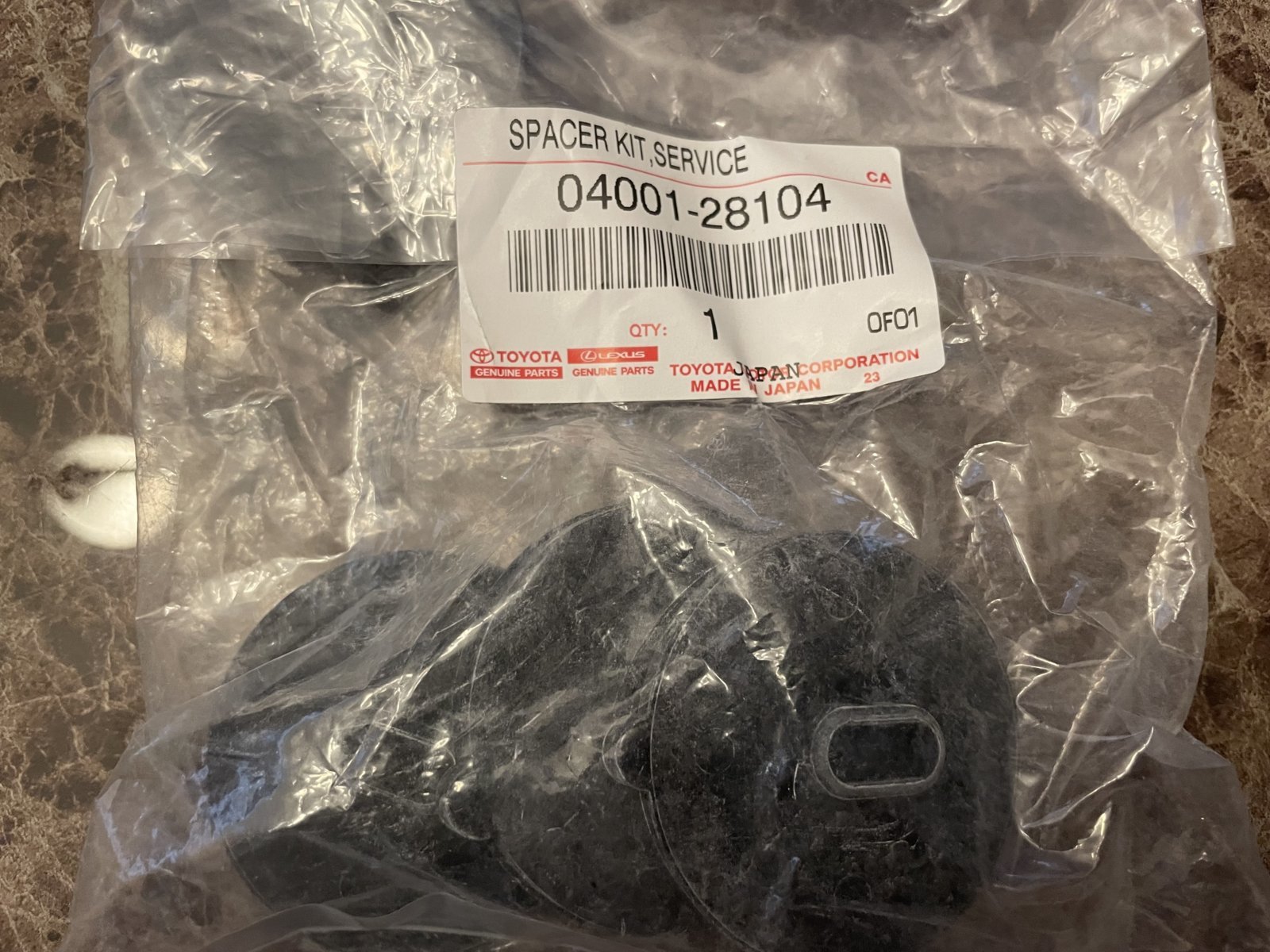

    One or more of your rubber isolator pads between the leaf springs have worn out. Replace them with these. You can either pick them up at your local dealer or order from a Toyota parts store online to resolve the issue.IMG_4330.jpg

    that’s not necessarily the case. I have a ‘23 with spring squeaks and it doesn’t even have 20k miles on it.
