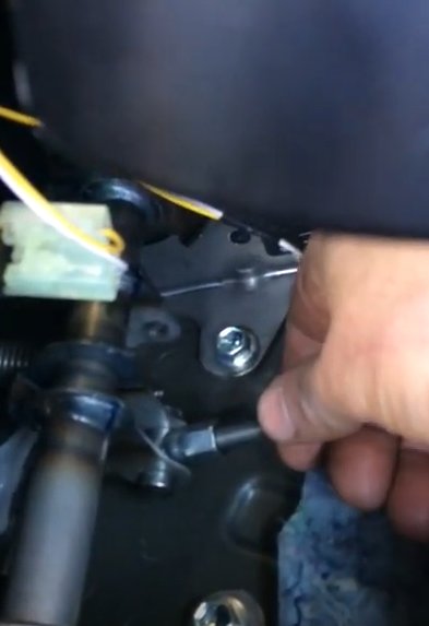

    Taco team,
    I have this strange noise (almost sounds like 2 wires crossing each other) inside the cab of my 2018 Pro. I have taken to the dealership but since it's not a constant noise, the dealer couldn't do anything about it. Is anyone else have the same issue? thanks.

    There was another video posted on this forum that it was connected to the e-brake. He removed the center console and jiggled this rod which appeared to be the culprit. I am having this issue too!
