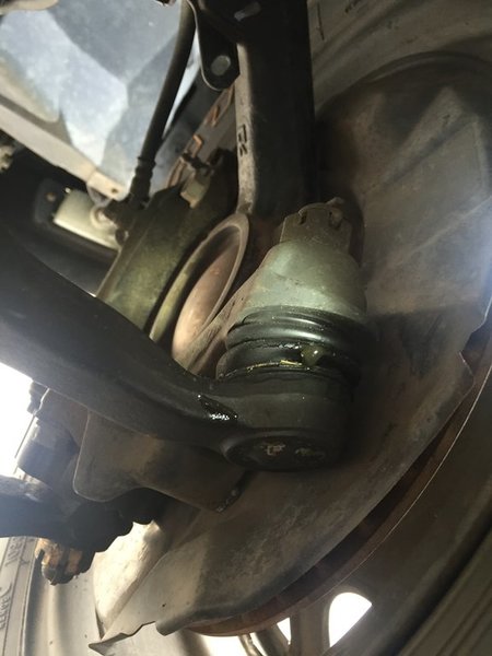

    Other side making noise now.
    Is this the culprit? Both the ball joint and tie rod seems old / worn out to me.
    (And obviously leaking grease)

    only way to find out of they're "worn" is if you lift the truck by the control arm and move the tire to check for play. watch to the end. mainly after half way.

    also, its difficult to see the lower balljoint. best way to check this is by lifting the tire while it's jacked up at the control arm.
    and your tie rods look fine, honestly. little leaky, so replace them relatively soon. just not that important.

    It's identical to the noise before just on opposite side, which was fixed by replacing the two parts. I'm assuming that's the issue. They are in fact worn.
