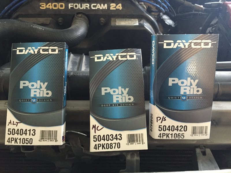

    Good news... the belts were the problem, I got the belts in today and replaced all three and the engine bay is much much quieter and the chirping sound of sort is completely gone. I have to say the power steering belt was a pain in the you know what to replace, no easy access to the adjustment belt from any angle... finally just had to feel for the bolt. Anywho I went to the Dayco belts and so far they are good, only time will tell how good they really are. For those interested the part numbers are below:
    Alternator: 5040413
    A/C: 5040343
    Power steering: 5040420
    I also replaced the idler pulley while everything was taken apart, just in case.
