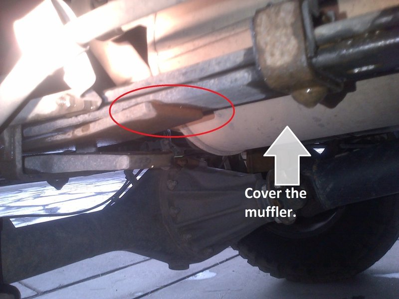

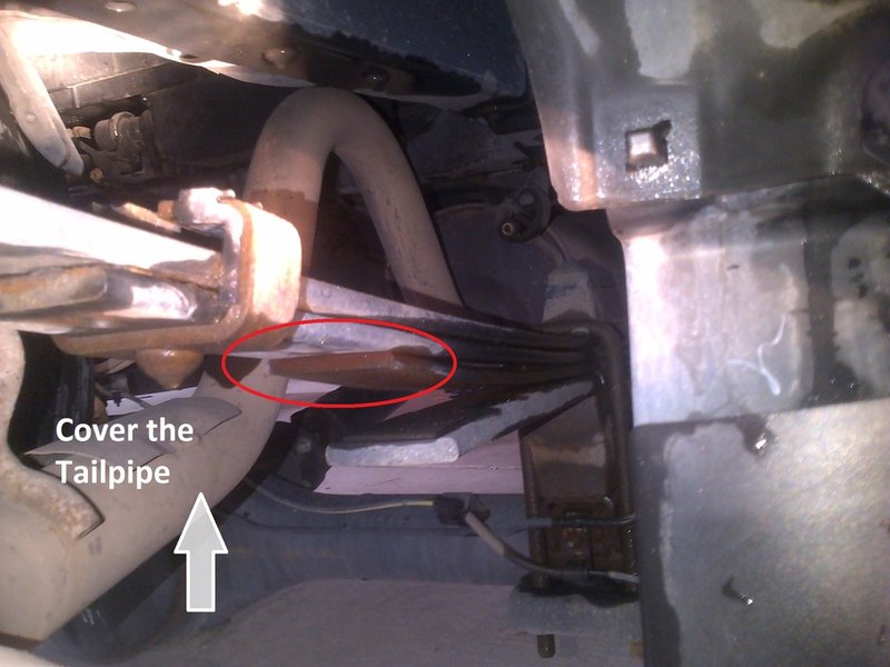

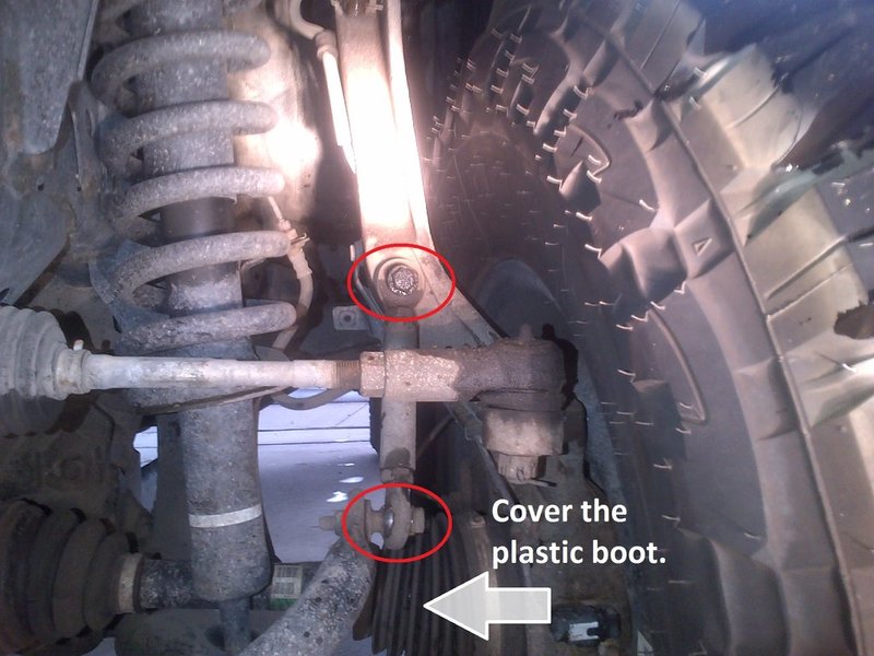

    I took my truck to the shop that installed the 6" lift kit and was told that there was rust in the lift components and that it would cost $800 to replace the parts. I rejected to replace the parts and was then told that the guys expected my response and had lubricated some components to keep the problem away for a while. Sure enough, the problem returned about 4 months later.
    This time, after a rain storm, I noticed the squeak had gone away. So I took some photos of the wet lift components (leaf springs and such) that were lubricated by the rain. A week later I applied CRC White Lithium Grease on a very small dose to these same areas. The squeak is now gone. I know the lubrication will need to be repeated every 4 - 6 months, but at least I now know where to apply it. Remember that this grease works at very hot and very cold temperatures, so avoid applying it by mistake on surrounding components like exhaust system components, spare tire, plastic boots, etc.
    Front Tires (repeat for the Front Passenger Tire):
    Make sure you cover the plastic boot with a rag. Apply a small dose on each of the circled areas in the picture below. The lubricant will automatically get into the metal-on-metal zone, so don't worry about manually smearing the lubricant into place.
    Rear Tires (repeat for the Rear Driver-Side Tire):
    You will be working near the exhaust system and spare tire. SAFETY FIRST: Exhaust system components will be hot if the truck has been in operation, wait until these parts have cooled down before attempting this part of the lift kit lubrication process. Avoid getting the lubricant on surrounding components and wipe any residue off immediately with a clean rag. Small doses is all that is needed.
    Now I can pull into my driveway up a curve and can actually hear the shocks compressing and other hardware parts moving. This is a lot nicer compared to the squeaking that existed there before.
