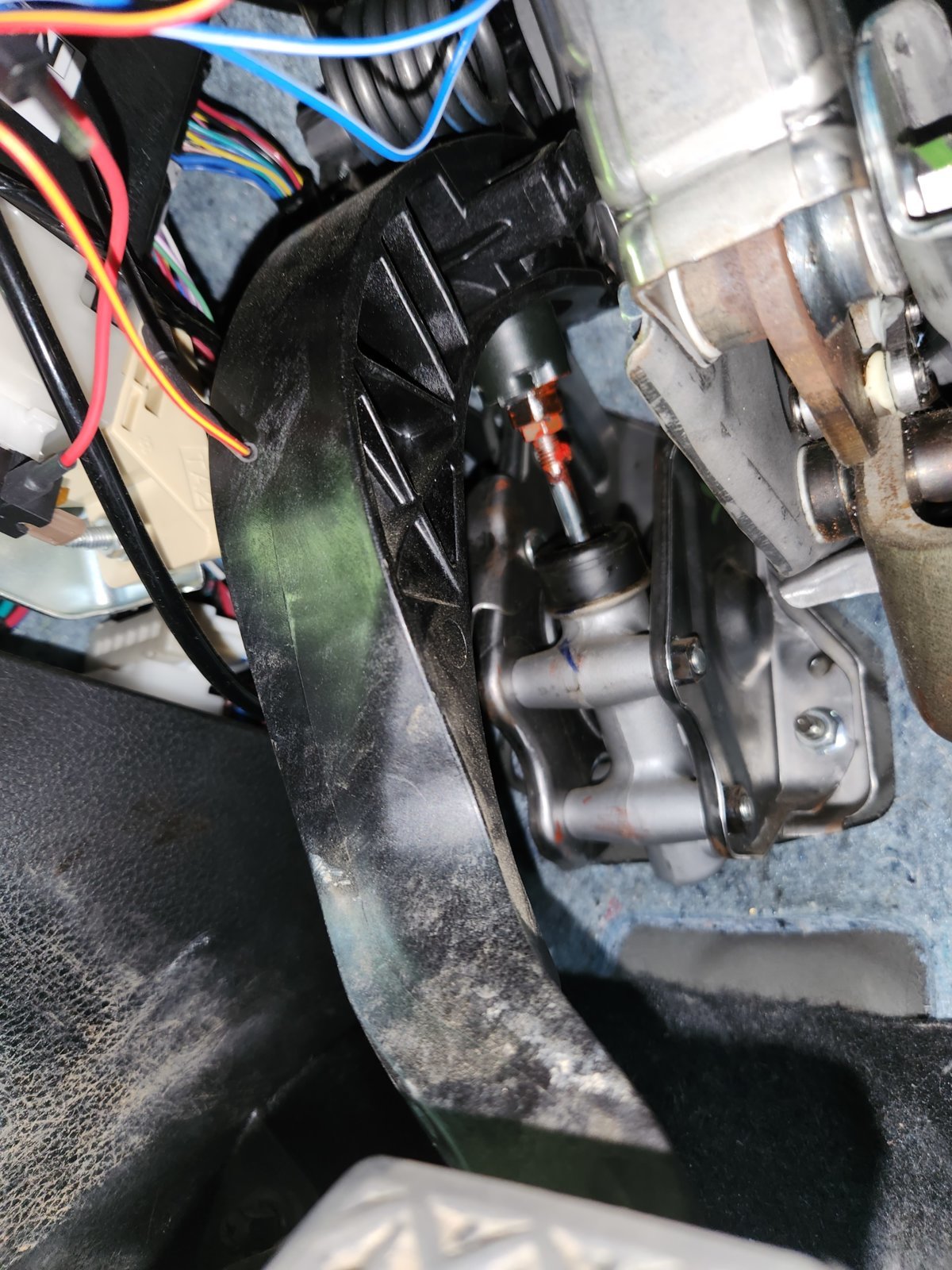

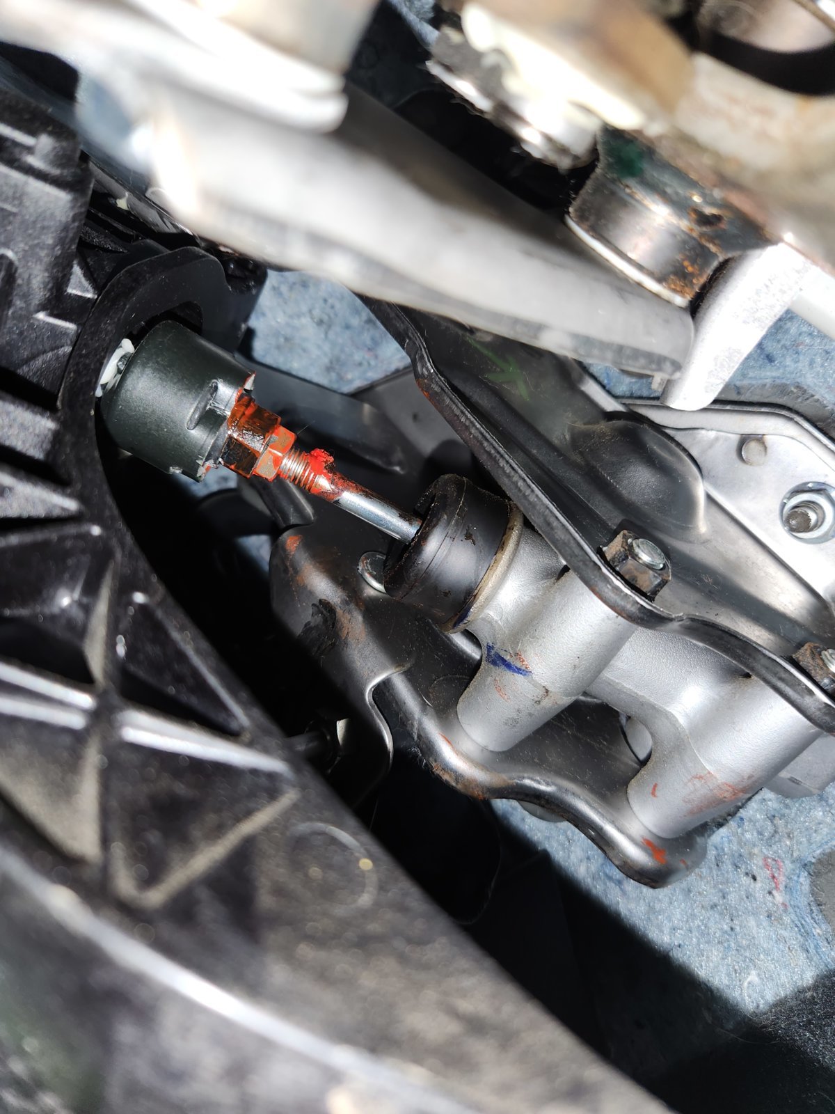

    I had the same issue, 2021 toyota M/T. I fixed mine entirely with disk brake quiet from Auto zone. Had doubts and was going to take it in for warranty but never heard the squeak again. Below are the locations I greased and for context this was July 2023. No issues since.20230714_155554.jpg 20230714_155559.jpg 20230714_155620.jpg
