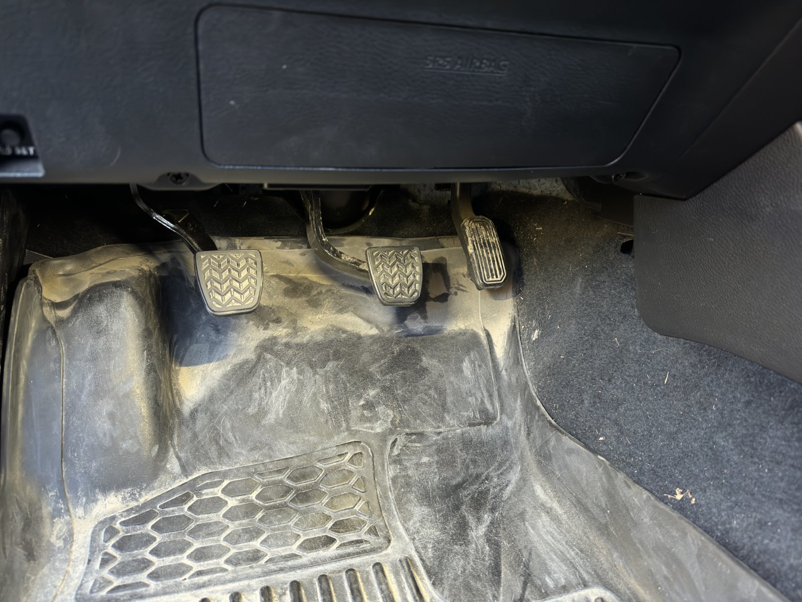

    It looks amazing, I never understood why the Clutch Pedal is made of plastic.......Is that a FJ Cruiser Clutch Pedal? So it fits in a 3rd Gen Tacoma? Wow I didn't know that, can you give me the part number or a Link of the pedal? Did you replaced anything else other than the Clutch pedal?

    Yes, it's an FJ Cruiser pedal. They have (had) a metal pedal that fit the exact same shape of the stock Tacoma pedal. No idea why they decided to come up with a plastic pedal for the 05 Tacoma, then a metal pedal for the FJ, and then continue both for each vehicle all the way through the 3rd gen, yet they did.
    Here is my write-up on it. Don't be too intimidated, I broke it out into literally every possible separate step I could. That makes for a long and seemingly daunting install, but it wasn't too bad.
    The parts I used are listed. It's the pedal, master cylinder, and some other piece parts to make it work. So far so good.
    How to Swap Your Plastic Clutch Pedal for a Metal One from an FJ Cruiser | Tacoma World
