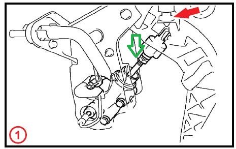

    I also have the squeak. It started around 5k miles. It began to get annoying as other have stated, typically on the way up, not down. I sprayed a little wd40 in there, where the shaft enters the cylinder, and it didn't really work well. However, I noticed that my shaft and bolt (as noted by the green arrow in my pic) have a little play in twist, left to right. Not much. I can't exactly tighten them by hand. When the squeak comes back, I just twist the shaft left /right a few times and the squeak goes away for a day or 2. It's odd. Just wondering if I can tighten this in some manner without damaging anything. Thanks!

    My exact situation on my 2013 5-speed. Try using silicone spray lubricant, it works much better and for much longer than WD-40. But yes, after spraying it in that part you have the green arrow pointing to, you have to spin that shaft around a few times -- to work it in I guess. I've heard that lithium grease works best, and I'm planning on buying some soon to try it out.
