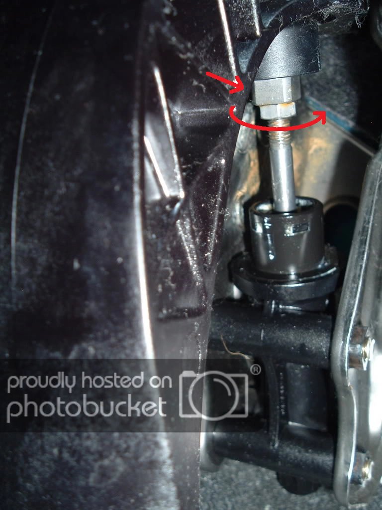

    I had a loud squeak from the outside of the truck every time I pressed or depressed the clutch pedal.
    I followed these instructions and fixed the issue in about 30 seconds - https://www.customtacos.com/forum/128-2005/97704-squeaky-clutch-still-problem.html
    This picture was taken from www.customTacos.com, but I added the red arrows to show what I did. This picture is of the clutch pedal assembly from under the drivers side dash. I hand-turned the silver piece counterclockwise about a quarter turn and the squeak went away right away.

    which silver? Big or small?
