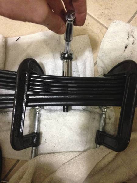

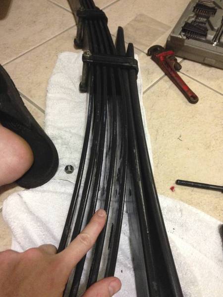

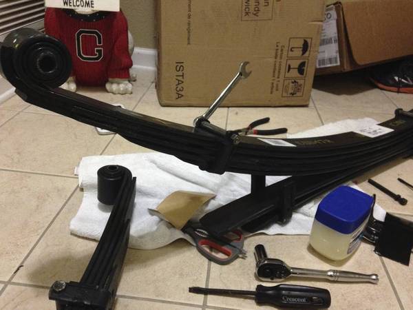

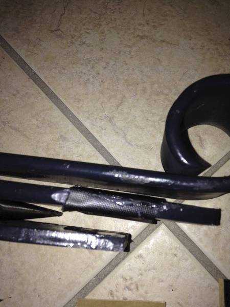

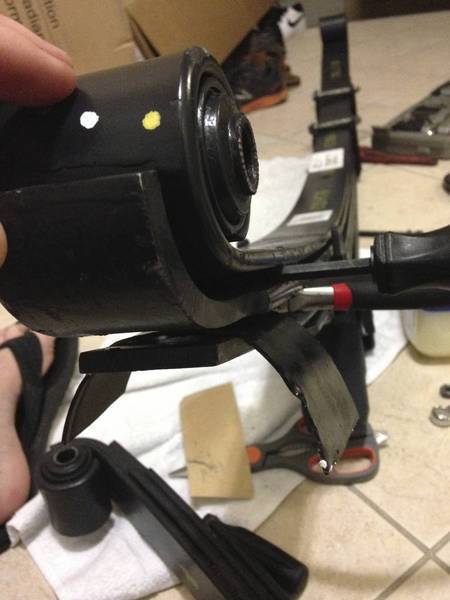

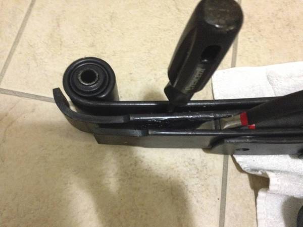

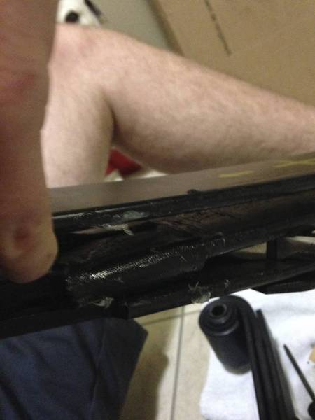

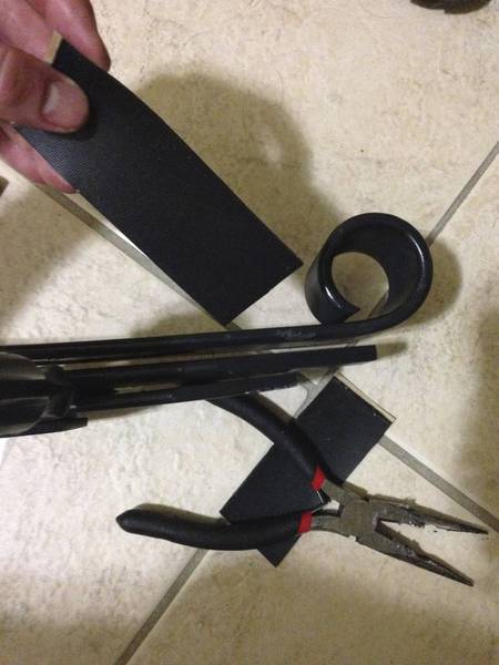

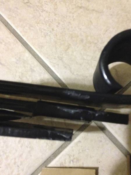

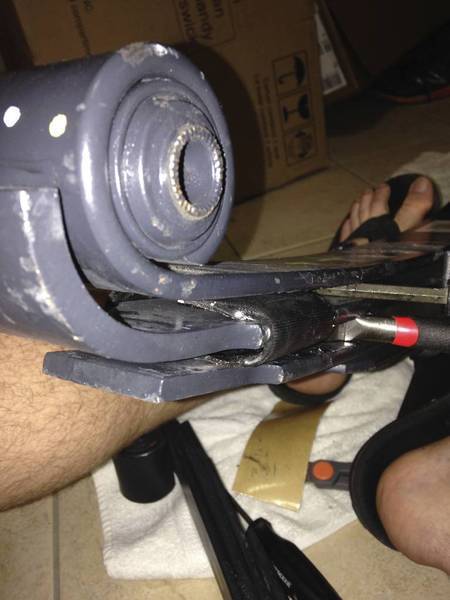

    Before I put my Dakars on the truck I took them apart to put the Center pin collar in (incase shims are needed later after the install). While apart I followed what the OP (OZ) recommended adding some EPDM to certain locations of the Dakars (Front near bushing)
    I went ahead and added some extra EPDM near the rear as well and added some Lube in both areas as well as between the leafs.
    here are some pics.
    threw some lube in between too.
    now onto the rear
    Longshoreman likes this.
