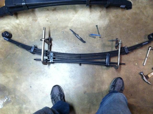

    I did the preventative maintenance to my Dakar Leafs as recommended
    Thanks to geekhouse23, I was able to get the Pond Liner Strips a lot easier....Good looking out man, Much appreciated!!
    Thank you OZ-T for providing us with the fix to this issue & all the feedback.

    Damn. Thanks oz. Did you put anything in there to hold it in place or just shear pressure from the leafs doing the job? Mine are squeaking like hell and makes my almost new truck sound worn out.
