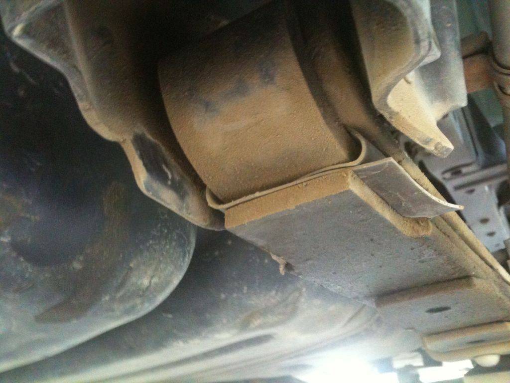

    I use a screwdriver from each side , do one leaf at a time , for instance , I pry apart the top leafs , slide the EPDM strip in , centring the strip , release that leaf , seperate the next ones down , slide the tail of the EPDM in from each side , release those ones
  6. May 9, 2014 at 5:33 PM
    #246
    OZ-T
    OZ-T [OP] I hate my neighbour
    Dec 15, 2009
    #27584
    50,582
    Peter North
    British Columbia
    You can see how I tucked the bottom here

    So you have a solid strip from to to bottom?

    No , there are isolators on the lower leafs , I only use the strip on the upper leafs that lack the factory isolators
    The strips I use are approx 2" x 12"
