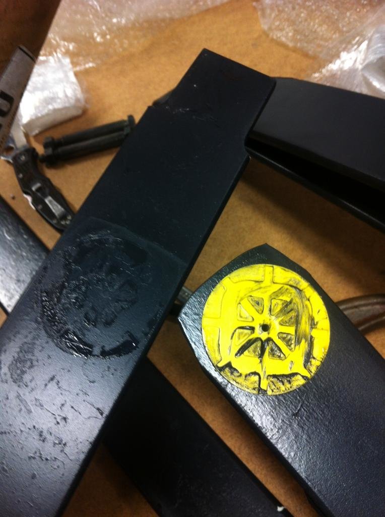

    It wouldn't hurt to put a little more grease on the yellow leaf isolators. The come very lightly greased and there is room for lots more.
    Here's a pic of how mine came:
    E9EFA8E4-E54F-4765-9647-123B3A1887B7_zps_7bb52f8fa8746fde945c1285b5254de2678f92c9.jpg

    Both of my packs were that way. The only grease to speak of was the little bit shown in the pic I posted. I needed to put my top overload in so I just broke the pack all the way down while I was already that far. I'm in this process right now. I'm not at all that impressed with the thin paint that came on these. Heck, the packing tape that was on it from shipping even pulled paint off it, and sitting in the back of my truck in the rain for a day started them to rust. I'm debating stripping the small amount of grease on them and hitting them with some paint so they don't look like junk yard leaves in 6 months.
