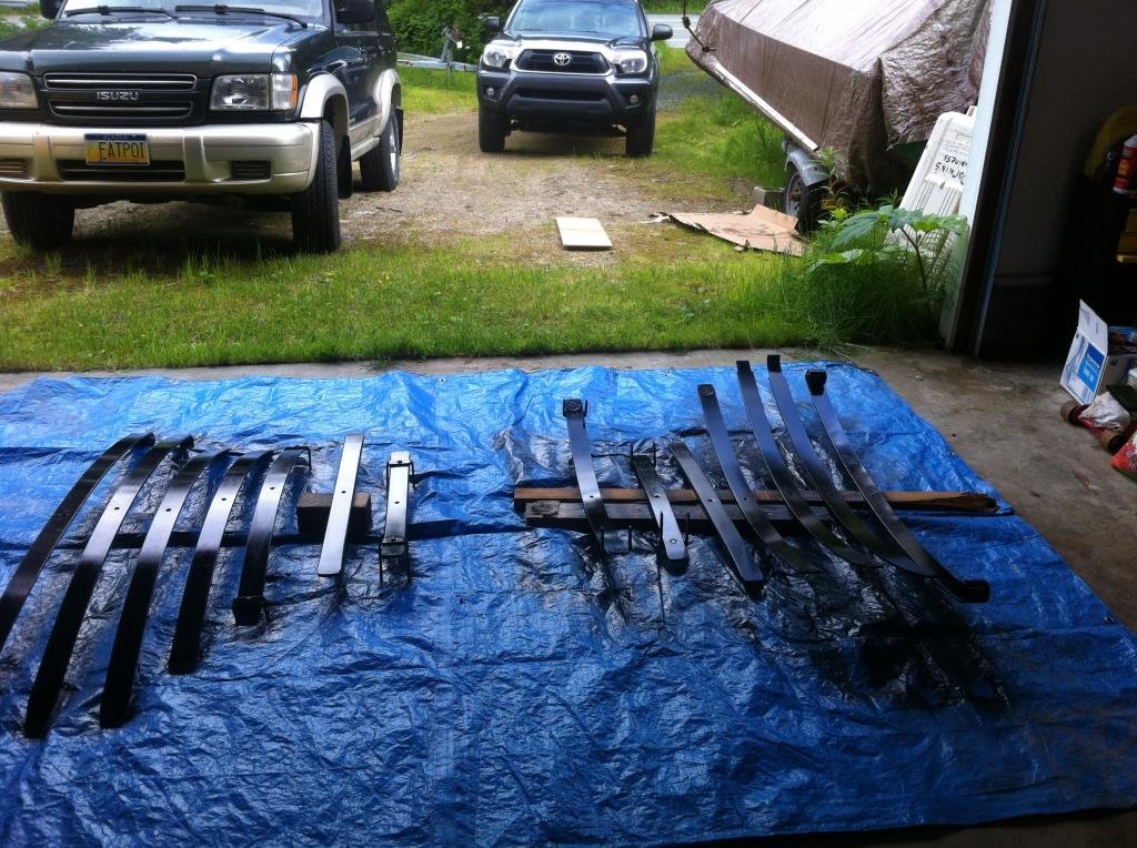

    I found some Fluid film locally. So I'm set on that. What's the general consensus on greasing between the leaves? I've heard both ways. I was thinking I'd fluid film them and then grease them up and slap them together. Am I just making more work for myself here?
  10. Jun 22, 2014 at 2:43 PM
    #290
    TrueNorth
    TrueNorth Well-Known Member
    Mar 1, 2014
    #124305
    177
    Maryland
    13' V6 4X4 DCSB
    Weather tech floormats and visors, ImMrYo rear-view mirror bracket Cooper ST Maxx 255/85/16 On stock TRD alloys. OME 887's w/NitroCharger sports, LR uca's, Toytech sway bar relocate, Dakar leaf's modified with some 1/8" UHMW liner strips. SuperBumps front and back.
    Thanks. That seems like it should work fine. I'd rather not install a shippery pack. I'm going to have two sexy packs by the time this is all said and done.

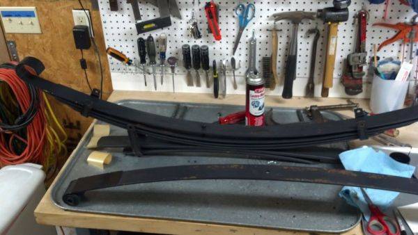

    Here's my version...
    I bought a 2' sheet of 40mil PVC shower liner at Home Depot and cut it into 2.5" strips. I sandwiched a strip of liner between all leaves except the bottom two overload leaves. Chassis grease on everything. Its not pretty but I'm hoping it'll work and last.
    One question...the addition of the liner made me have to compress one side of the pack to get it under the inner most retainer (right side of first pic). Should I remove the bolt for this retainer?

    Are those zip ties ?
  13. Jul 8, 2014 at 10:02 AM
    #293

    My suspension knowledge is limited(but I'm learning as much as possible) and I'm no Dakar expert like OZ but, if those are Zip Ties...I'm thinking it might not be a good idea to have them between your leafs.
  14. Jul 8, 2014 at 10:13 AM

    Yep, those are zip ties.
    I was kind of wondering the same thing as I was putting them together. I tried to stagger them so they didn't all stack up in one spot and create a huge pressure point.
    I could easily release some tension on the pack and pull the zip ties out. I just didnt want the PVC sheeting to work its way out from the leaf pack.

    I just wrapped(overlapping) my rubber sheeting around the leafs that will come in contact. I think that the pressure of the leafs being pressed together should keep the liner in place. See my picture below:
    I'm under the impression that the idea behind the pond liner/rubber strips is to have a very thin but durable material placed in between potential problematic contact points on the leaf pack. If I understand correctly, it's best to have a very minimal amount of space between the leafs. Note, in the picture above, I have yet to tighten the Center Pin down to compress the leafs together.

    I don't think it will hurt anything but they may cut your sheeting or snap from the leafs pinching them

    I think what I'll do is relieve the tension and remove the zip ties from between the leaves. I'll then install longer zip ties around the entire pack by the two retaining brackets. The end result should be the same; keep the liners from working out of the pack. :)
