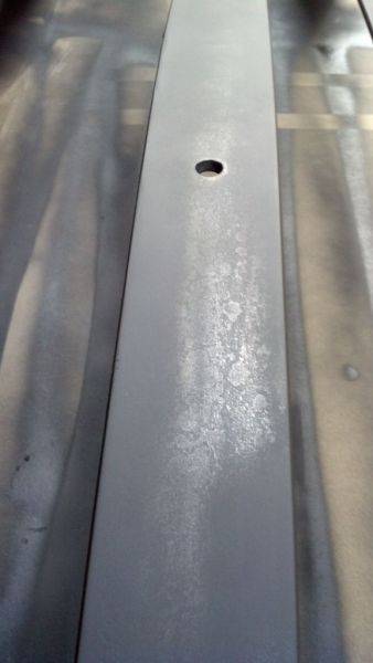

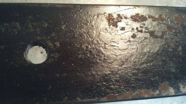

    So after reading jberry's rebuild on his Deavers (using a process Deaver uses) and seeing the rust blossoming from mill scale on my brand new just-delivered and as-yet uninstalled packs, I decided to take preventative measures. I am ditching the pond liner squeak approach to take preventative action on the decay that has already begun.
    I took them all apart, flap-disked the worst of the superficial rust/peeling paint flakes/mill scale off between leaf contact surfaces, providing a much smoother and complete contact surface between leaves (much less friction) dressed/chamfered the tips, and ditched the pads. I also picked the very large paint flakes out of the rear eye bushing grease.:rolleyes:
    Then I did a light dressing of rust refromer on the areas that will be in contact, or heavier rust reformer in hard-to sand/grind areas around the leaf clamps.
    Eliminating the pucks will allow the leafs to fully contact each other and will eliminate the generous gap between leaves that allows lots of moisture/water/sand/pebbles to get between the leaves in the first place to cause problems and premature wear and corrosion. This unbroken interleaf contact footprint will be buttered with CRC dry moly lube.
    Overloads are unlike the Deavers, and they had little to no rust or scale except for the formed bends on the leaf clamps, so they needed minor cleanup and got two coats of Rustoleum satin.
    Once the pack goes back together, I'll give it another coat of Rustoleum.
