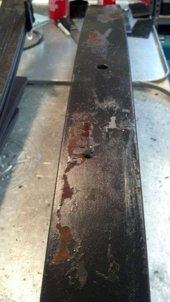

    I took my new Dakars apart. I cleaned them really well. The OME factory put wet grease between the leafs. I cleaned all that up, wiped them down with acetone. Then I cleaned off the flaky paint, and sprayed them with new paint. I'm going to use some moly dry lube and rebuild the leaf pack. I got that pond liner patch kit stuff, gonna use a little bit. My install should be in six days. :D

    I did what OZ said. I used a 6" C-clamp. Pretty easy stuff.
    Yes! lol prefurbishing.
    Your previous post with pics on the subject was very informative. I slightly resent the labor to prefurbish them, but whatever, I plan on keeping the truck a long time so I guess it's worth it.

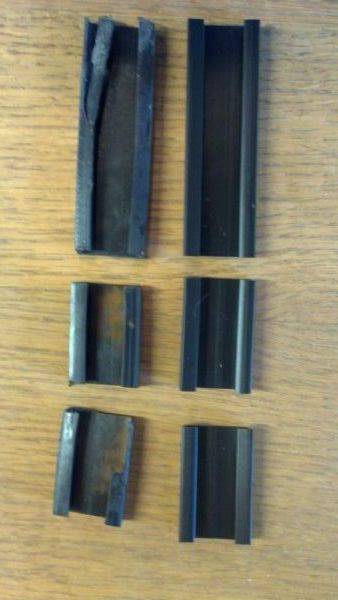

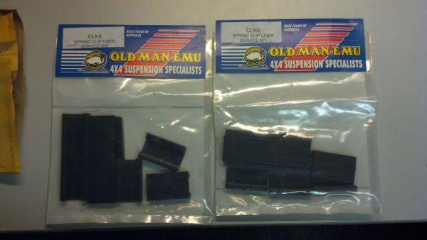

    FWIW, mine looked exactly like yours. Flaky paint and all. Did you call ARB USA to get the replacement plastic / rubber spring clips? Mine were almost all destroyed in shipping.

    I was fucking pissed. I was getting ready for a long road trip, and this added fucking days to an already busy prep and truck service schedule, and my right elbow was injured at the time.
    Anyway, glad you found the info helpful.
    Yes, call ARB customer support, they will mail you a fresh set free.
    CLK6
    Both these are "new" LOL. They don't survive shipping.
