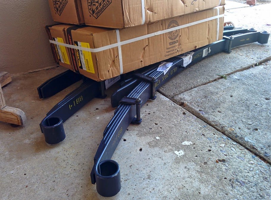

    Here is how I received my springs. Zero packaging.
    I saw your post with paint, looked good. Gave me more motivation do to mine. :thumbsup:
    I did a lot of research on which product to lube the springs. Dry lube seemed the way to go. Moly and or PTFE. I got both and will use both when I rebuild my pack.
