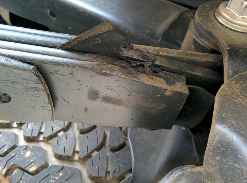

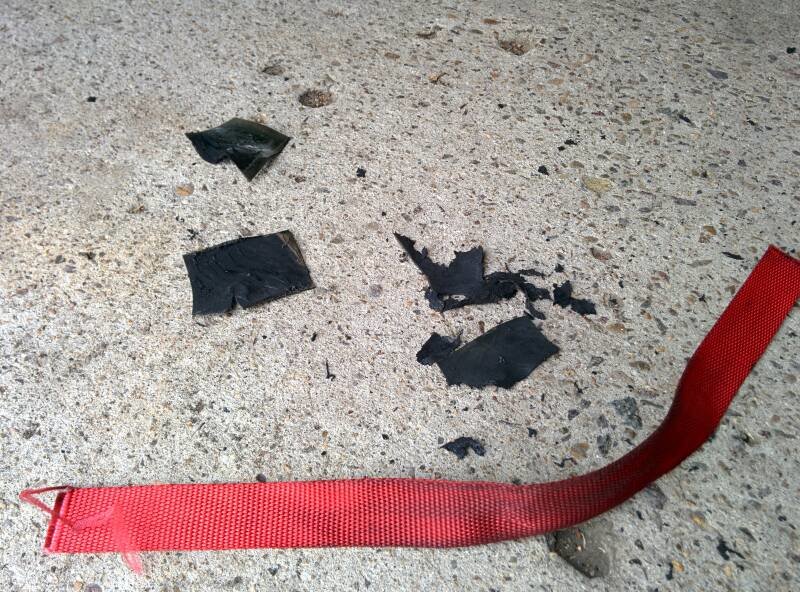

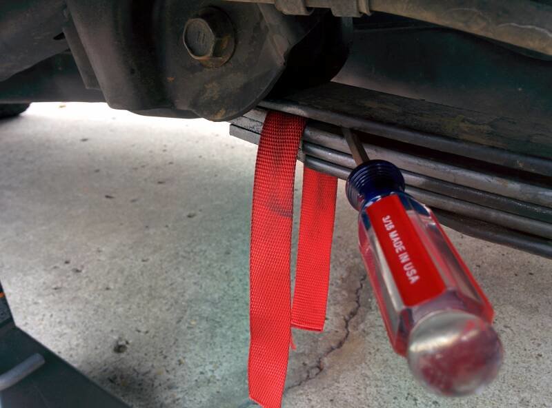

    Despite the extensive prefurbishment work, with the pond liner EPDM stuff, it only lasted 41 days, and 1000 miles.
    Some leaves held the EPDM better than others. Nevertheless, I drove the leaves apart, cleaned it all out, and sprayed it with the dry moly lube.
    Hopefully I won't have any more squeaks for a while, and I won't have to murder something. :)

    Honestly I wish I had drilled holes in the leaves and installed the mechanical silencer pads.
    Mechanical adhesion seems like the only way for permanent success.
    The Toyota TSB leaves had them installed. They were completely squeak and maintenance free for six years.

    Agreed. I love the soft ride of the OME kit with Dakars compared to the go-kart suspension in the TRD Sports.
    FWIW I did the OZ squeak fix and looped the pond liner back on itself and it has already backed off partially. The Dakars are rejecting the transplant. There's still rubber in there though and no squeaks reported.

    4K+ miles on the Dakars, and the squeak got annoying. Bought the kit from post #143, installed the EDPM with adhesive backing in the OZ-T location, and blessed silence ensued.
    Thanks to OZ-T for getting this figured out!
