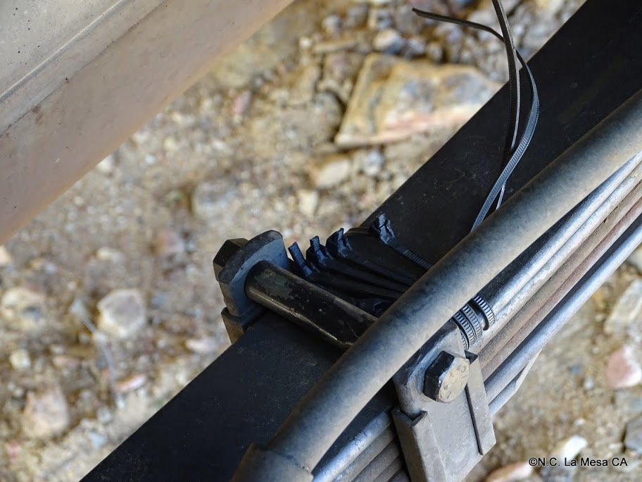

    I like the leaf spring tip inserts. I think Dakar should have them installed in all leaves except overload.
    I had time to try and diagnose my squeaking leaves, and I am not 100% certain yet (need a mechanics stethoscope), but I think mine are squeaking at the urethane bushing. I greased it really good on install day, but I think it's squeaking now. The crappy thing is, there is no way to service the bushing with more grease? Anybody have any ideas?

    No , I'm seriously , I like the liners you linked
    I'm wary of drilling holes at that location of the leaf spring for the inserts but that may be unfounded

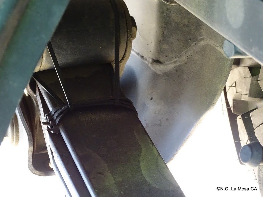

    British Columbia
    I found the creak to sound like it was coming from the front bushing but it was actually coming from the military wrap on the leaf without a tip insert

    I just ordered this: Lisle 52750 Automotive Stethoscope Kit. It should help greatly in pinpointing where the noise is coming from.
    I was actually referring to the rear bushing which, in my case is urethane. The urethane will squeak like a mofo without maintenance. The front bushing is rubber and is pressed in at the factory by Dakar and will / should not squeak.
    I also ordered this: Lumax LX-1416 Silver 18G 1-1/2" Long Stainless Steel Grease Injector
    Not sure it's going to work, but it's nice to have and if it does, I'll jump for joy.

    Nice .
    Yeah , I went with the OEM Toyota bushings for the rears in my Dakars and have never had squeak issues from them

    I use WD-40 for every metal to metal squeaking noise around the house. So when my Dakar started to squeak, I just sprayed it into the gaps, and it would go silence for about 2 weeks.
    Rinse and repeat every 2 weeks for me :)

    I used seafoam on my rear bushings and found thats where its been squeaking.. least for me.. I know its not a long term solution but least I know where its squeaking at

    Oh yea.. it bubbled a bunch out.. and so far ..only been two days but has not squeaked since

    Drill holes, put isolators in. It's the only way for 100% success.
