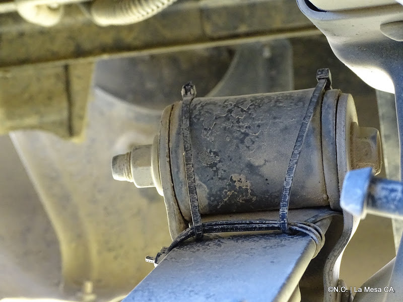

    The silencer pads ( leaf spring spacers) are great. My Toyota factory leaves had them and they never made noise. If I could confidently drill the requisite holes in the leaf ends, i would put those in today. If the zip ties don't hold up I think I may try...

    :thumbsup: Good to hear that. Keep us posted on how long they last.
    Edit, here was my attempt:

    The solution I used was three heavy duty Ty-raps at the front and rear on the second leaf from the top. Put them in the same day I installed the leaf packs. About 6 months ago. Not a squeak has been heard even with all the dust here in AZ. I used Thomas and Betts brand.
    A. That's what I had
    B. They've always seemed sturdier than a 3M or GB zip-Tys from a local home improvement mega store.
    I know they will wear but as of now, they show very little signs of wear

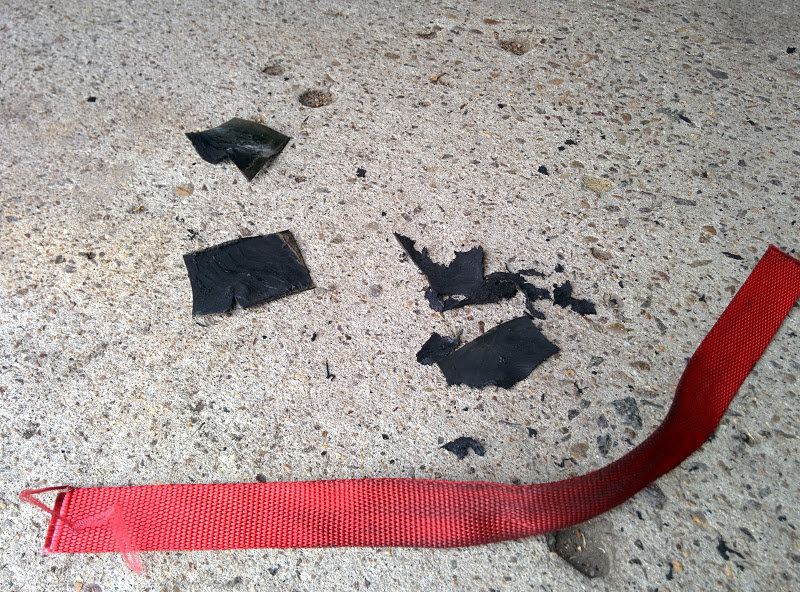

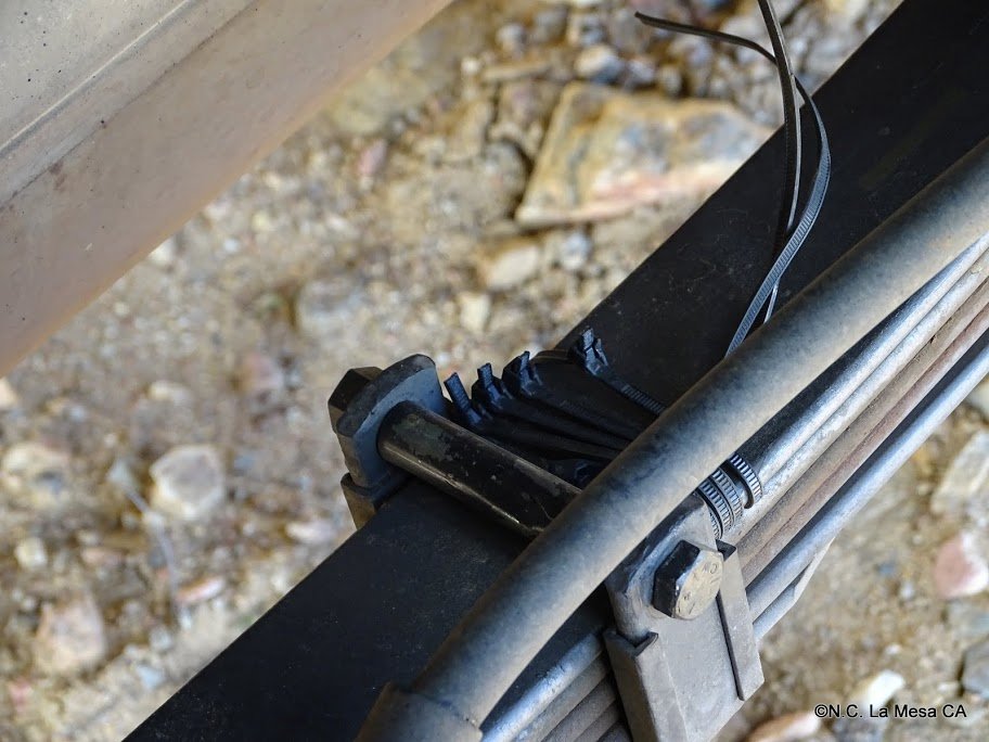

    I tried the pond liner EPDM stuff. Not as durable as I hoped. It lasted only a very short time for me. I off-road quite frequently so leafs are a-flexin' a lot, hence lots of chewing.
    GOod.
    I did mine a little different, by securing to the main spring.
    I discovered I had to secure them to the eye, or they'll walk down the leafs.
    And because I used not very strong tie wraps, they do occasionally break, and they walk.
    Next time I have the leaf pack off, I'm putting in some of these for a permanent fix.

    Nice. I've replaced my ty-raps at the front bushings, once on each side of the truck, the rears seem to hold okay. I think they break from off-roading.
    Excellent! My factory Toyota leaf springs never made one squeak in 5 years / 50K miles.
    If I ever have a reason to pull the Dakar leaf pack out of the truck, I'm drilling holes and puttin in some Dorman leaf spring spacers.
