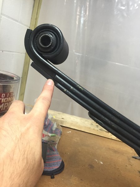

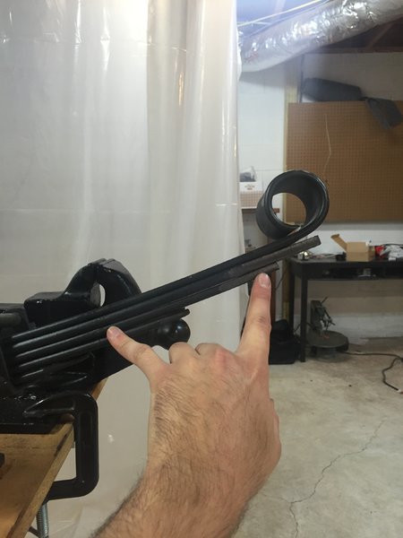

    Finally got all my parts in after they trickled in this week.. gonna prep my Dakars.
    Questions-
    • Should I prep both ends?
    • Also where abouts should I put the material I'm using? Close to my 2nd digit or my 5th?
    • And am I pointing to the right areas?
    • Also silly question but I'm guessing it doesn't matter which side of the truck the springs go on?

    Do they have a + , 0 , or - on them ?
  9. May 5, 2016 at 6:19 PM
    #649
    KaptainH
    KaptainH Well-Known Member
    Aug 16, 2015
    #161948
    2,276
    Kris
    Gainesville, GA
    Black 2013 DCLB Sport
    + on the front (I'm guessing the front is the side with the installed bushing.. haven't gotten as far as looking up how to do the install)
  10. May 5, 2016 at 6:20 PM
    #650
    OZ-T
    OZ-T [OP] I hate my neighbour
    Dec 15, 2009
    #27584
    50,582
    Peter North
    British Columbia
    Of both ?
  11. May 5, 2016 at 6:20 PM
    #651
    KaptainH
    Aug 16, 2015
    #161948
    2,276
    Kris
    Gainesville, GA
    Yes
  12. May 5, 2016 at 6:22 PM
    #652
    OZ-T
    Dec 15, 2009
    #27584
    50,582
    Peter North
    British Columbia
    Then no it doesn't matter which side . The two leafs without the isolators in your 2nd pic is where almost all my noise comes from , doing the rear doesn't hurt either
